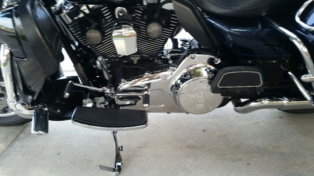

I run a set of Wards fans. I couldn't be happier. You can't get the Wards fans any longer but Love Jugs makes the Mighty Mite and a few others.
