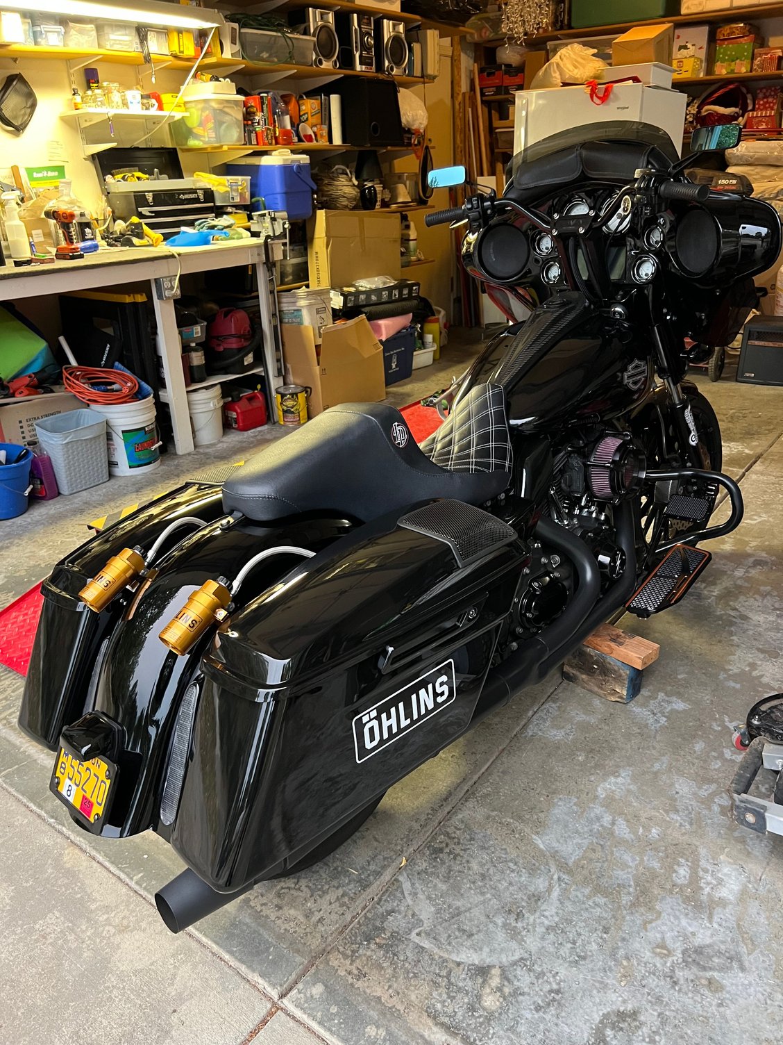

Yeah, these came with a couple angle iron brackets and several plastic curved brackets as well as some hose clamps to strap them down. But as mentioned, they mount to the down tube of your saddlebag bracket so they’re hidden behind the bags. For me that’s like having a tattoo someplace where no one ever sees it. As much as these shocks cost and as nice as the reservoirs look, I don’t feel like hiding them.

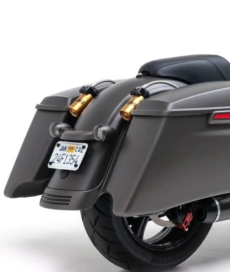

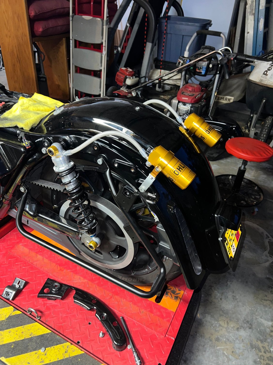

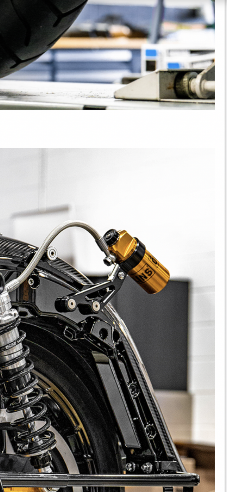

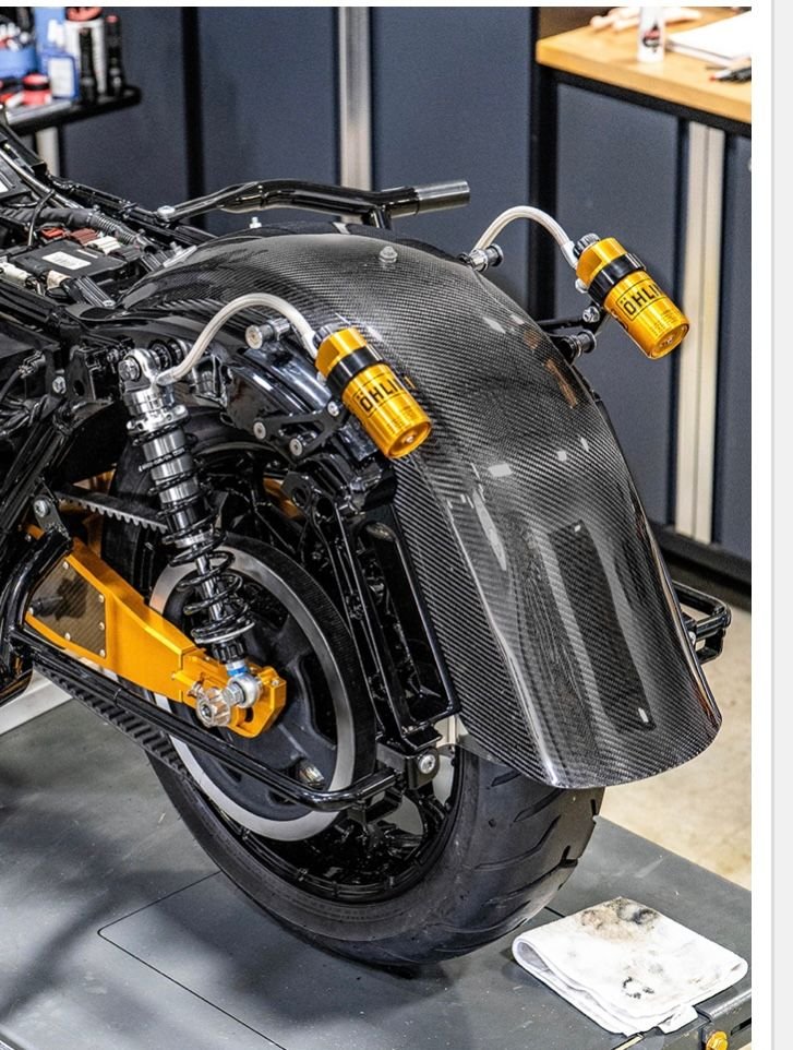

Here’s a couple samples of what I’m talking about….. I personally prefer to have them sitting closer to the bike rather than having them sit way up high. Not saying the taller look is bad… just saying I like them tucked better. (Like the first picture) the brackets in the 2nd two pics are Carbon Visionary. They’re $555.00 which is a little more than I’m willing to spend. Krause makes a similar set that aren’t carbon fiber and those are about $460. My buddy is making me some for free, so it’s a no brainer for me.

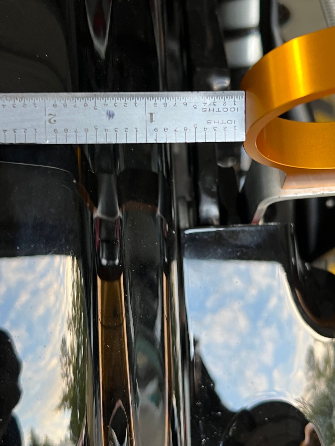

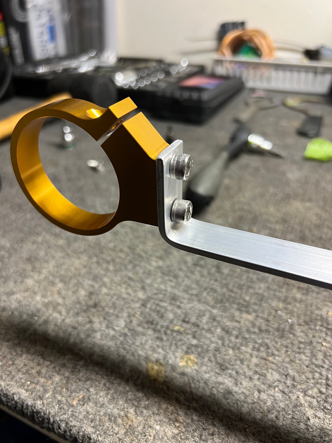

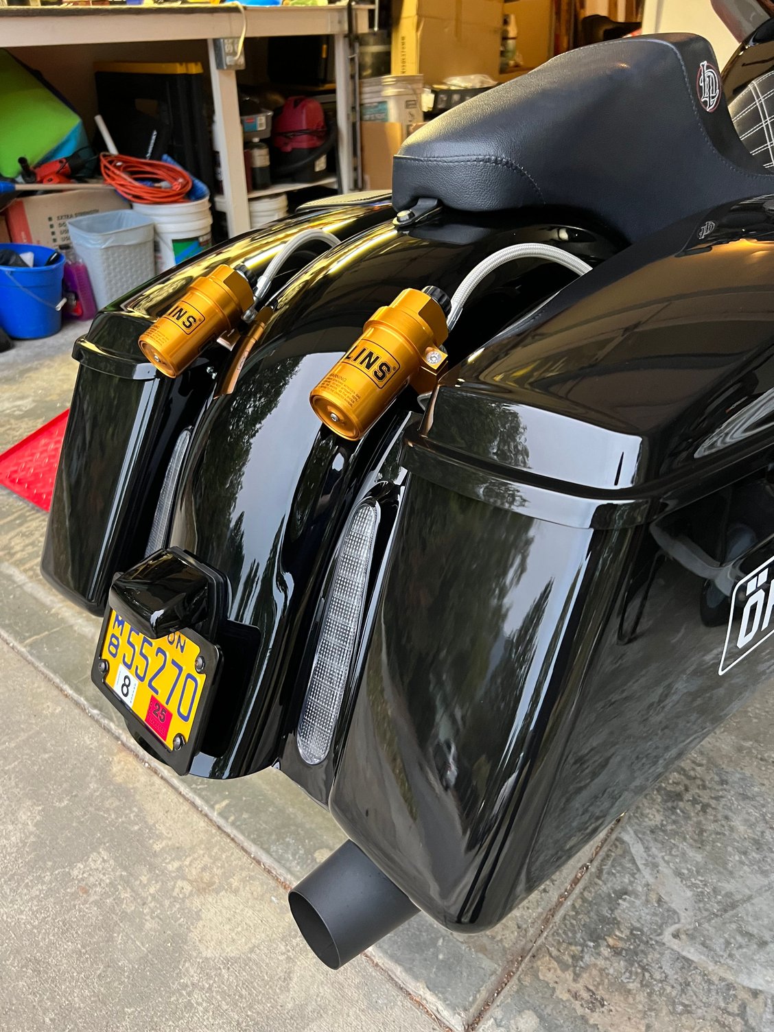

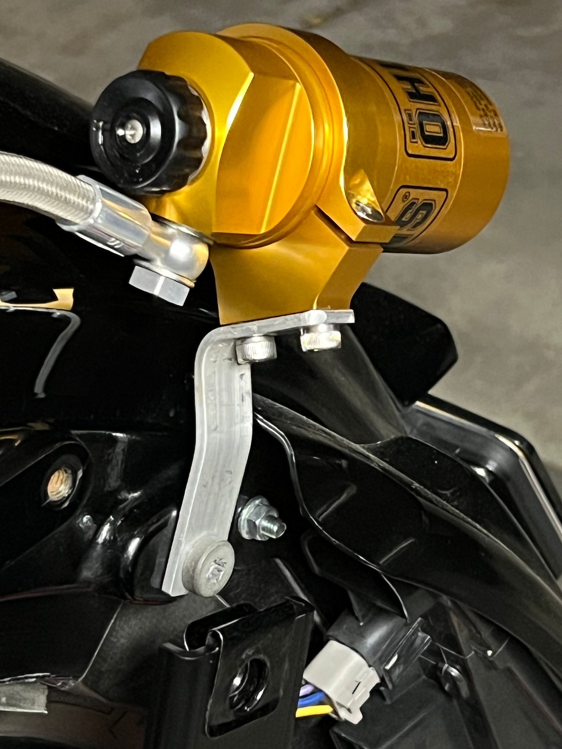

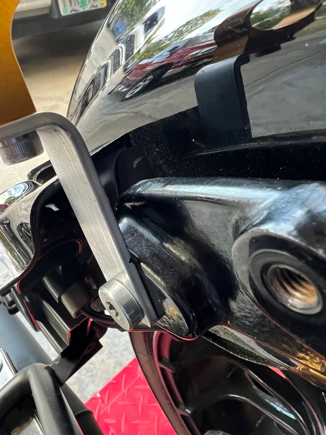

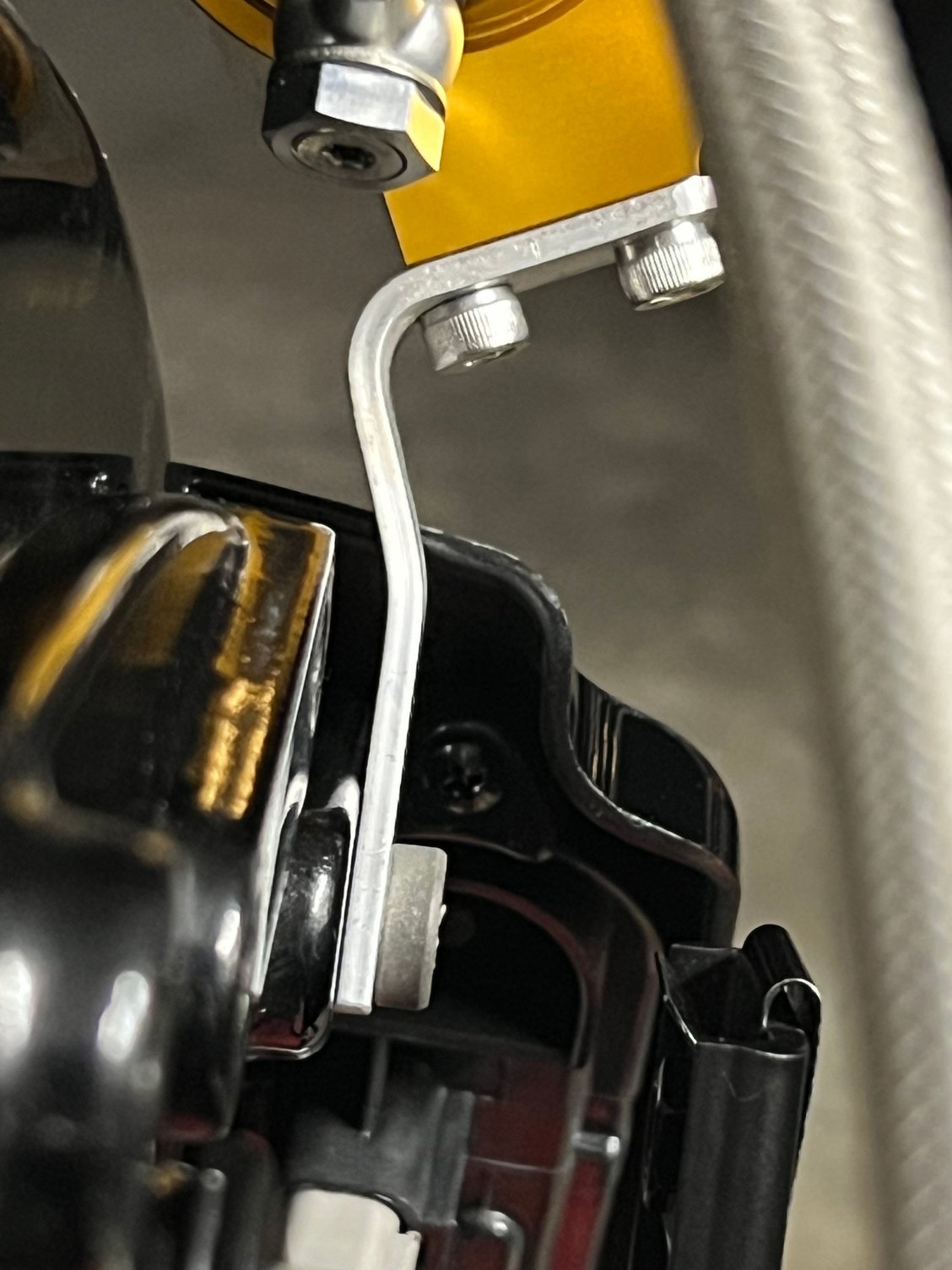

It was taking my buddy a while to get to the brackets, so I decided to just go buy some flat stock aluminum and fab up some myself. They may not have the same appeal as the $400 - $500 brackets out there, but I was able to get the reservoirs mounted exactly where I wanted them. As mentioned before, I personally didn’t care for how high those other
brackets put them out there. Cost me 5 bucks for the aluminum strap and a couple hours worth of measuring, bending, and drilling.
The straight 90 put them too close to the bags.
Measured the distance between the bracket & fender and split the difference.
Put just enough bend in it to center the reservoir between the fender and saddlebag.

Nice work and your bike looks awesome!
Looks good. The bling of the reservoirs always stands out. I've had countless people at shows ask me what they were. You'll get attention with them and the brackets are doing the job.
