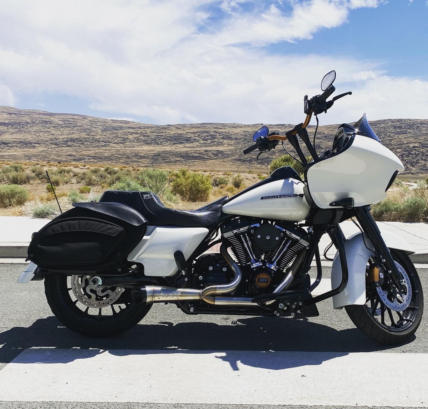

  #826
glock35's Avatar
glock35
Joined: Jun 2013
Posts: 250
Likes: 41
From: Nevada
Default Finally got phase one of this project done!
Legends Suspension F/R
TBR Exhaust
Fuel Moto intake
Leather Pro bags
Forbidden Risers/Bars (Bars are powder coated)
Krauss raptor plate
Power Vision Tuner (Fuel Moto)
still waiting on a few more parts to come in.
Old Jul 25, 2020 | 03:31 AM
  #827
gartec81's Avatar
gartec81
Joined: May 2010
Posts: 4,356
Likes: 887
From: san diego
Bike is looking great. Solid choices on the parts list for sure

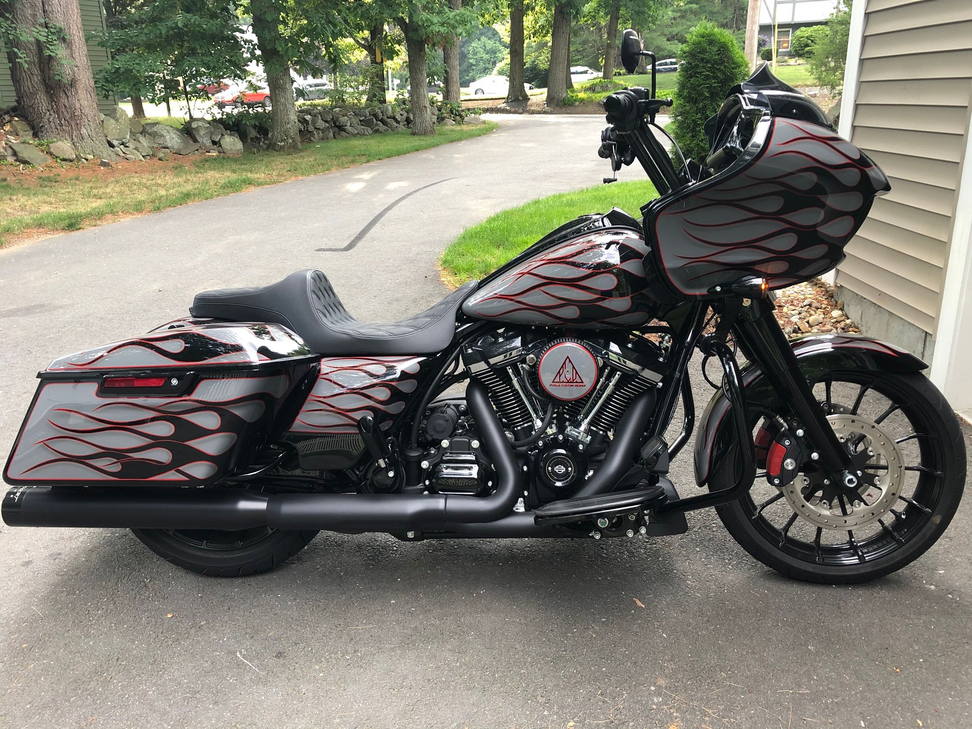

Originally Posted by Puglia10
Well I was just gonna do a 2-1 pipe. But then it needs a tune. So I might as well do a cam. And if I’m in there I might as well do an oil pump and lifters and blah blah blah...whoops! Lol. Adding some more horsepower next week, and it’ll actually sound like a Harley finally. Front suspension this winter, rotors once these wear/warp and that “should” be “done”...lol.
ok, I am in love...what a beauty
