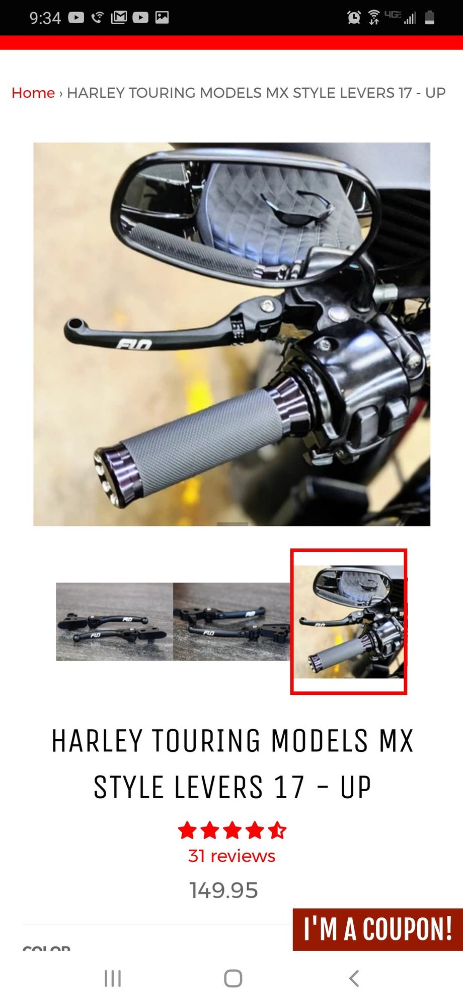

Question about hand controls- Anyone know if you can get "moto" style clutch/brake levers that use the stock master cylinders? Looking for something similar to the ones pictures on the Kraus website but hoping to avoid the large cost of the full setup.

flo motorsports harley mx levers

Thanks man, that's exactly what I was looking for!!

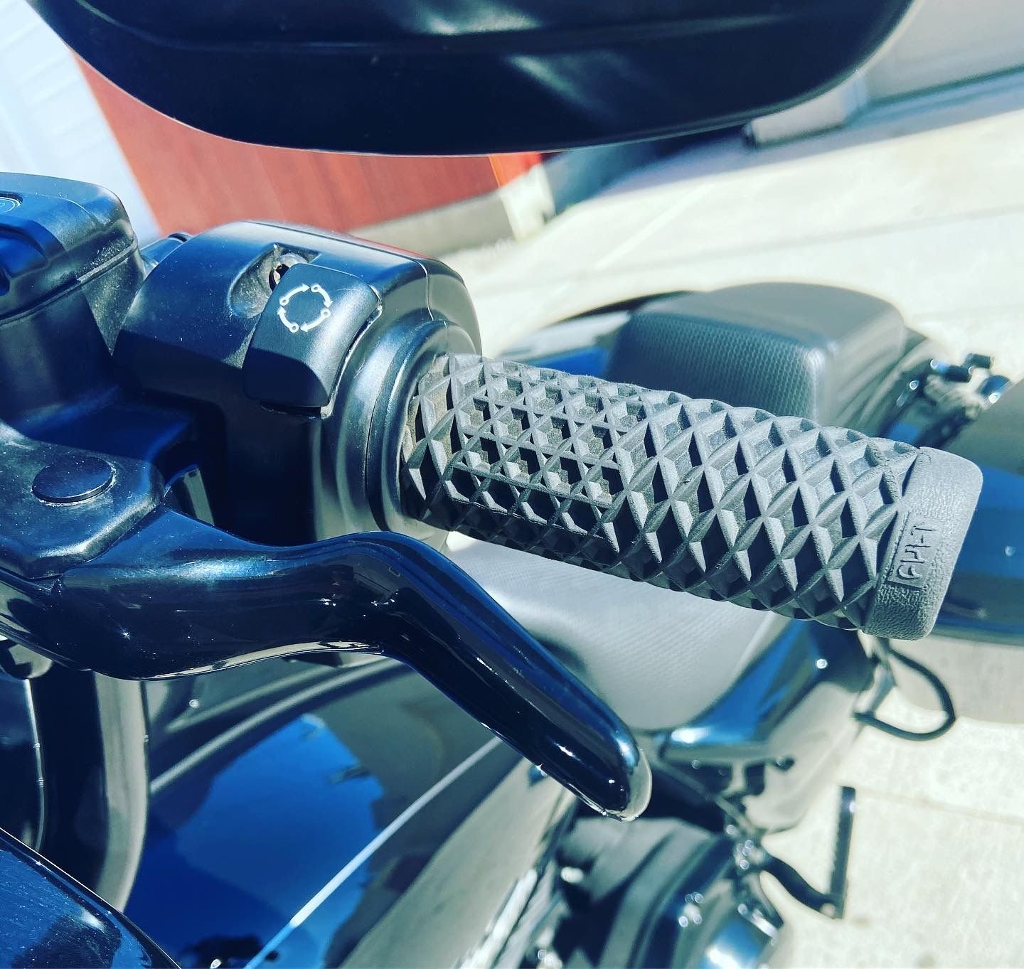

personally wasn’t a fan of the Flo levers. A bit flimsy, lever is narrow and cuts into fingers compared to wide OEM blade, and the adjustment mechanism moves the usable part of the lever towards the outside about 1”. This is very counterproductive to a “reduced reach” lever.
I ended up cutting and shaping my oem levers, then bent towards the grip an inch to get engagement with reduces reach.

nice job on your levers. I did the same on my dyna I had
