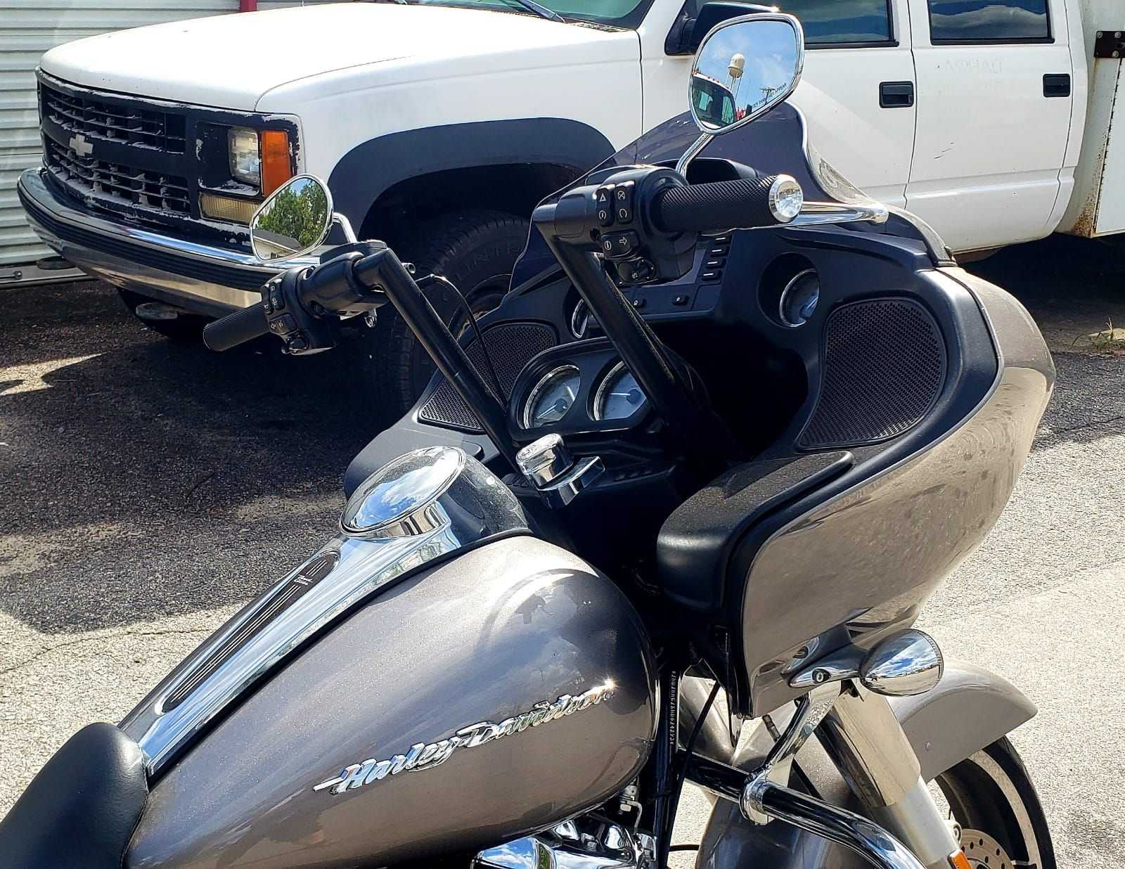

My 2017 Road Glide, it’s been a garage queen since I got it. Been in Afghanistan for the last 3.5 years and have done quite a bit to make it better than stick. Current mods include: 12” FXR Division Motowitch bars
Aftermarket black mirrors
Flo Adjustable levers
S&S stealth air cleaner
Bassani 2:1 exhaust
Powervision tuner
Klockwerks sport flare windshield
Legends 13” Revo-As in the rear
Legends Axeo in front
RS468 cam
S&S cam plate and oil pump
Carbon Visionary front fender (shipping now)
Lucky Dave’s seat (on order)
