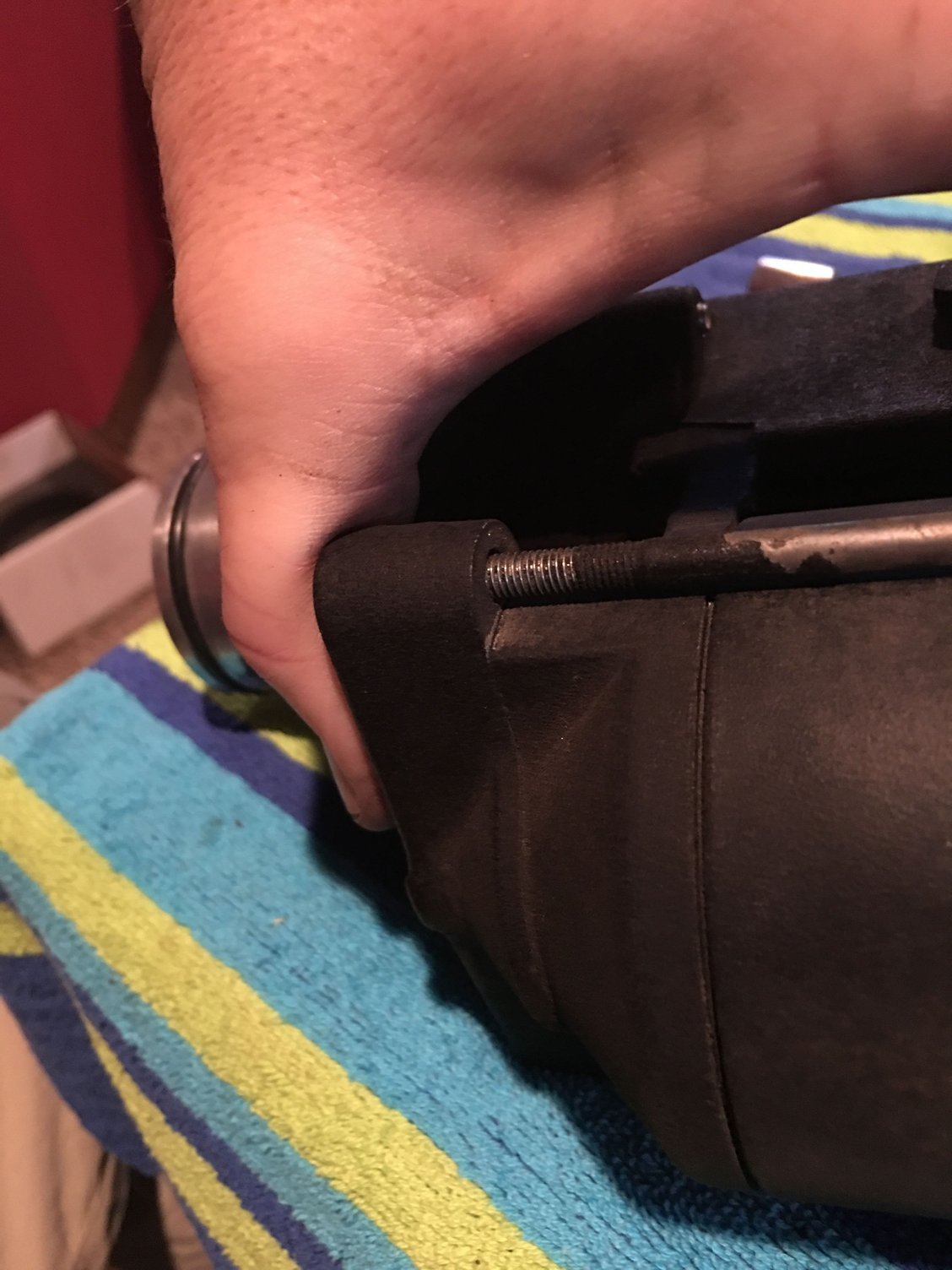

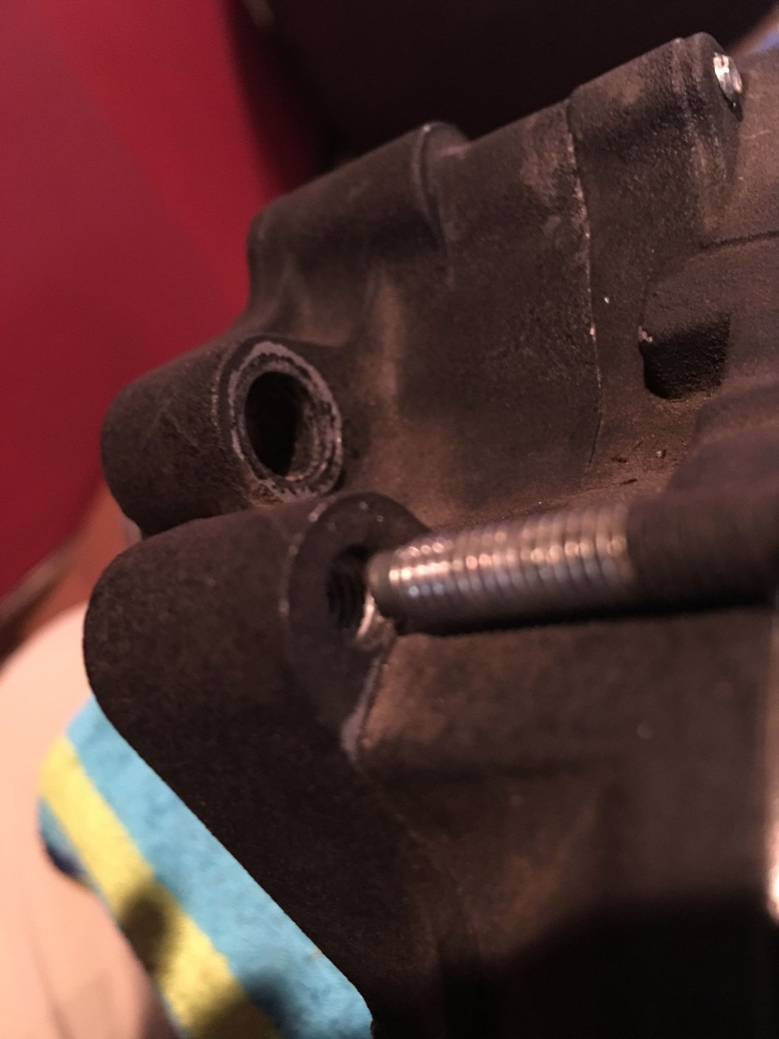

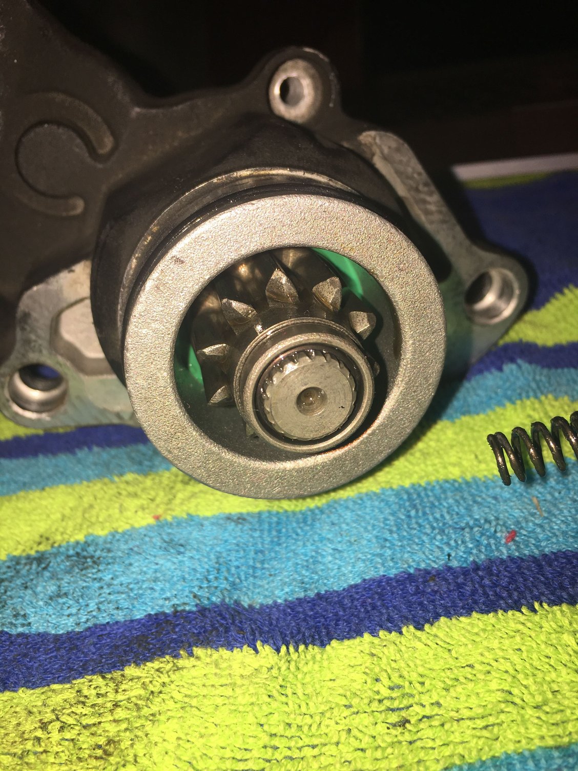

Was putting the starter back together and ran interest a snag. Came back to it today to see if maybe I was just having a bad day the first time but having the same problem.
One of the long starter motor bolts won’t screw in. It will if I try it without the motor so I can get it further in to ‘catch’. It’s like maybe the first threads in the body that it screws into aren’t catching it. Any options or ideas? It’s like I need a bolt that just a hair longer....
thanks,
steve
Old Apr 7, 2018 | 12:20 PM
  #69
dawg's Avatar
dawg
Joined: Jun 2006
Posts: 28,562
Likes: 3,956
From: Vermont

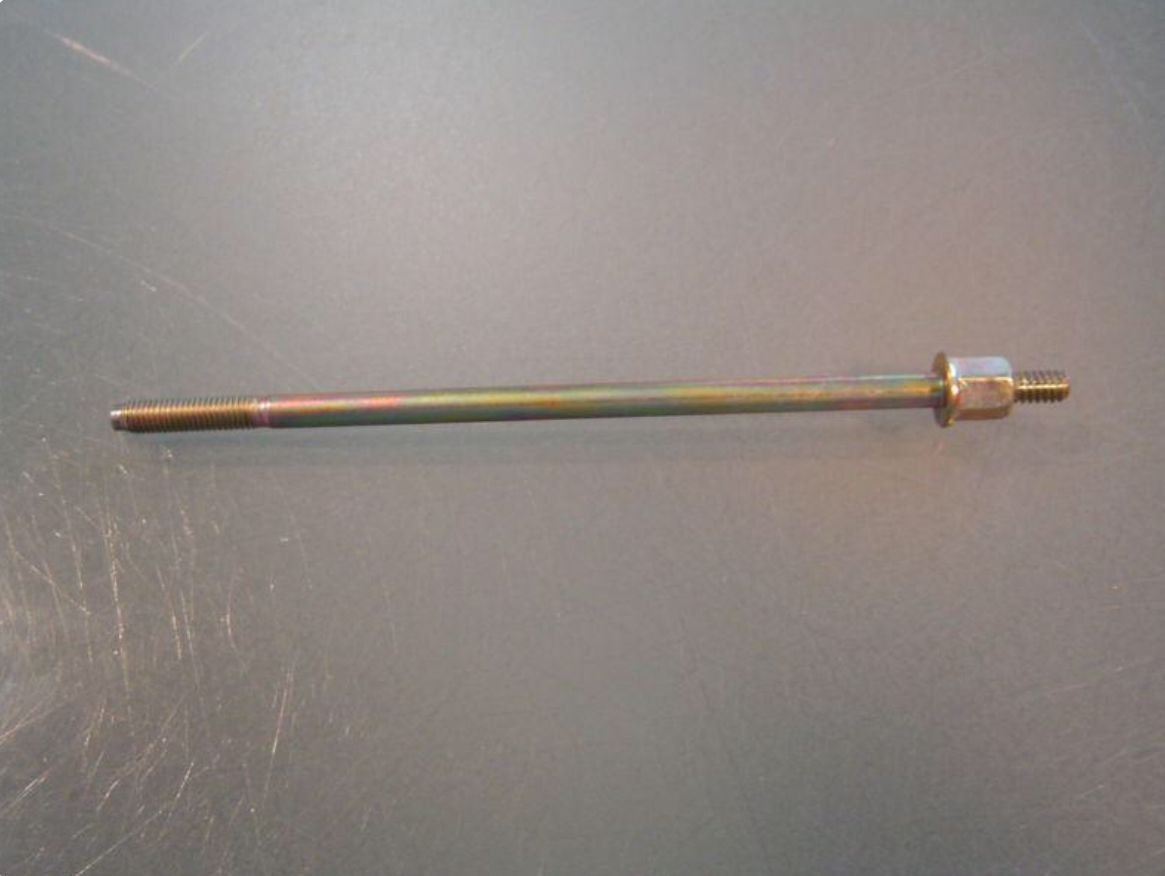

Does the long bolt have the nut on the other end that can be adjusted like in the pic? If so, was it moved to where it shortened the the threaded end you are working with?
it does have that nut on the other end, but it doesn't look adjustable. I didn't actually try because it looked like it was solid. I'll give that a try. Thank you.
