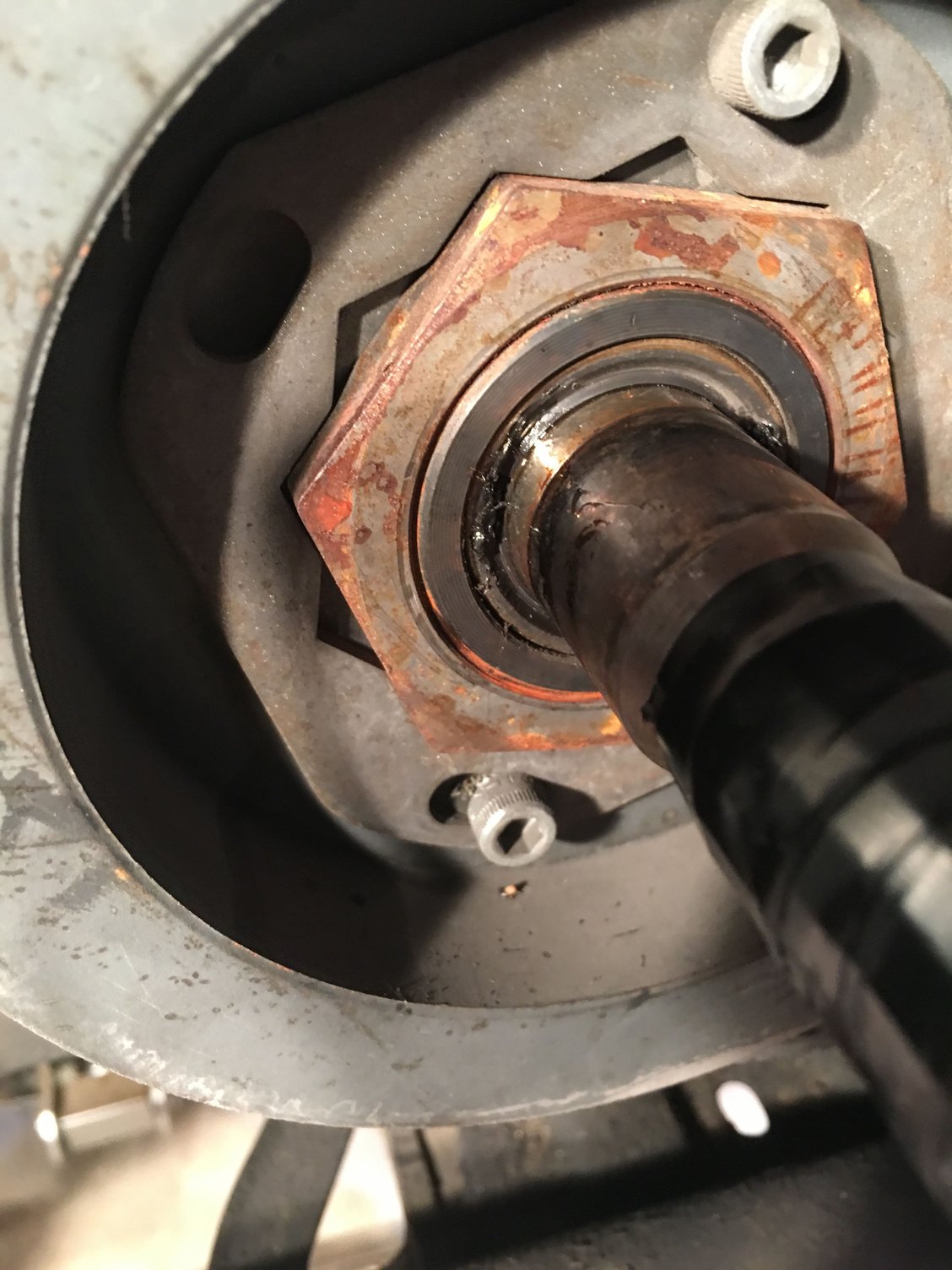

For some reason I knew I’d get to this point....I need some more advice on getting this seal out. Bent Picks...screws pulled out...can’t get it to do anything.
please help. thanks,
steve

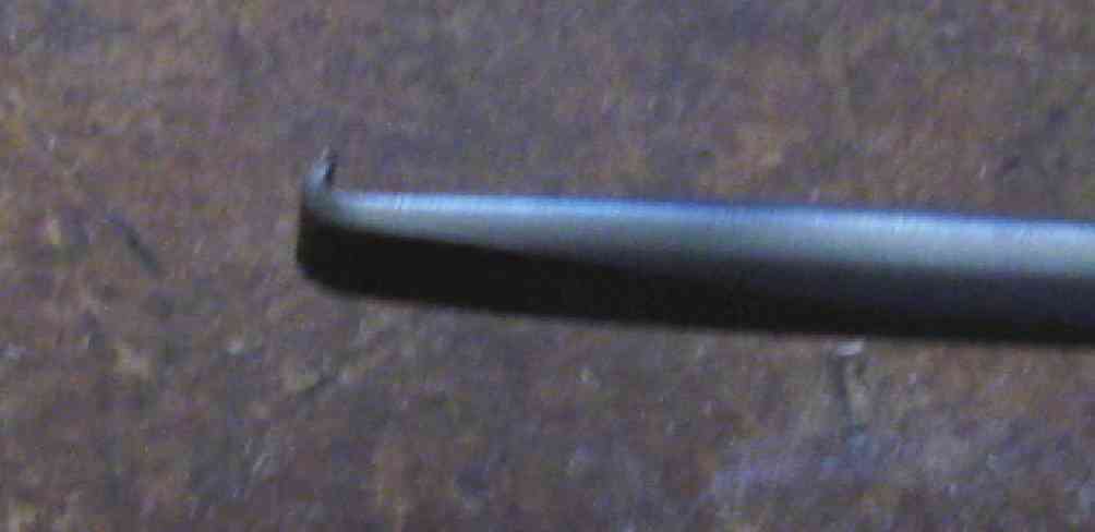

This is what I use..
1. Find a reasonably good screw driver with a 1/4 inch blade to be sacrficed.
2. clamp it in a vice with the end sticking up.
3. heat the end with a propane torch until red hot.
4. with a small hammer, gently bend the end of the tip over.
5. allow to cool in air slowly.
6. with a belt sander or even sand paper round the end some and smooth the outside edge.
To use simply hook the seal from the shaft side and attach as pair of vice grips. tap the vise-grips with a small plastic hammer in the direction to pull the seal. You might have to work your way around the seal some to get it out..

wood deck screws,vice grips and end of shaft as leverage. easy peazee.

If you have the new seal take a close look at it and see where your pick device has to go then work around it a little at a time some of the cheep picks will just straighten them selves out when you pull on them I like the one as shown in the pic that was made out of the screwdriver I did something similar
