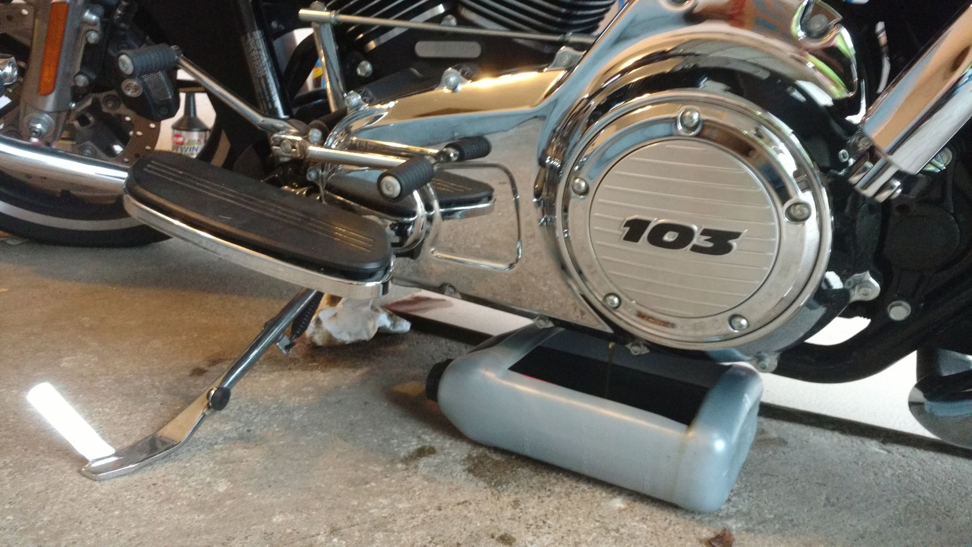

Forgot to thank you guys. Empty antifreeze container makes an awesome catch all.
