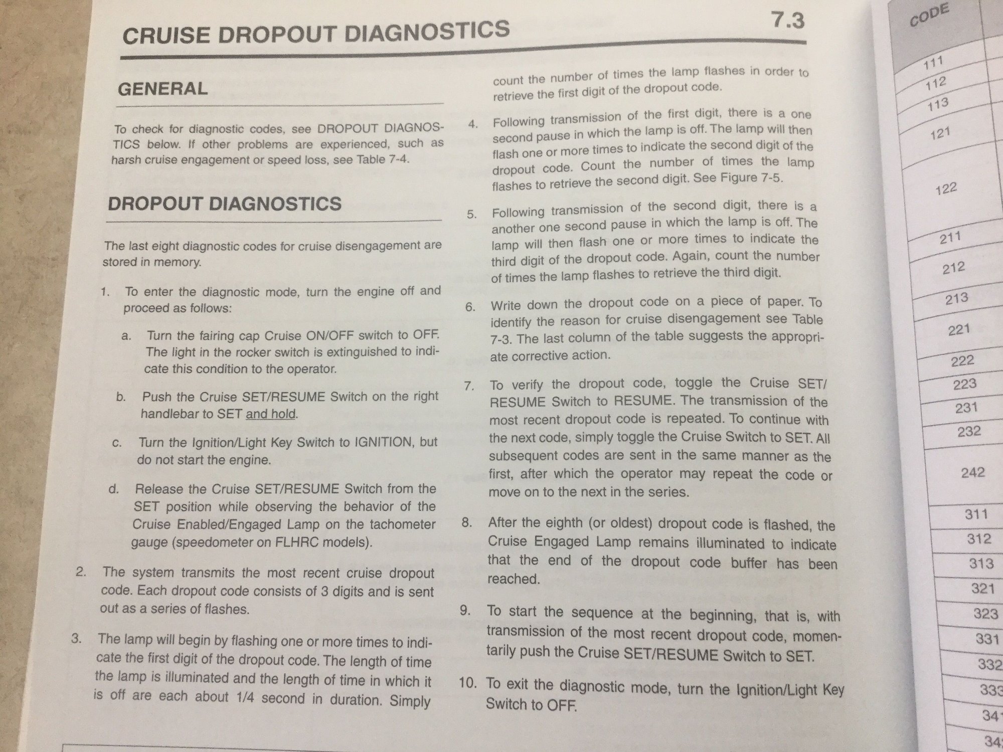

The pictures are from a 2004 Touring Manual
