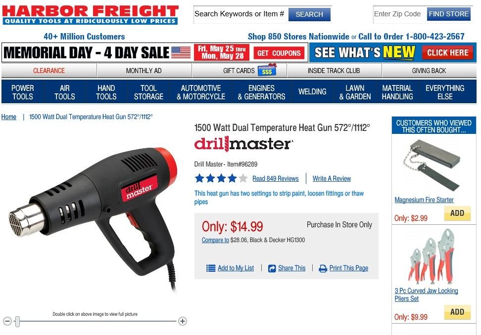

The adhesive definitely helps in keeping those ends together! I'll be doing another set this weekend (with a friend) and this time, I'll be using a better crimper! I'd love to find a faster heat gun though!

The HF Heat Gun is what I use, great tool and great value.
