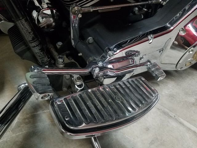

I was on my way on a trip up north last week when pulling off for fuel i had no down shift lingage on my 03 Road Glide. I made it back home w/ a bungee for a downshifter. anyway The cause was worn bushings in primary and stripped teeth on lever. I ordered all the new parts and JIMS tool to take out and install bushings but my problem is that Harley redesigned the shifter levers to Aluminum and uses pinch bolts & nuts to secure. My original shift levers were steel (12#) new Aluminums 4 #. Has anyone changed out levers to new lightweight aluminum? I am looking for some riders who used these new designs and there results. My original set lasted 14 yrs.
thanks

I recently had to replace mine too, as well as the shaft. It didn't occur to me that they were aluminum until I read your post, so I just grabbed a magnet, and they sure are. Ha! They work fine so far.

Just replaced my shift lever last week. around 160k miles on a 03 RKC.
While the inner primary was off the belt, clutches, swing arm isolators and chain tensioner got replaced.

you can drive those bushing out with a socket a 11/16 craftsman's fits mine

Not that it helps your cause. The shifters on my 2007 Ultra are steel. Almost one year and 8,000 miles later. Still good.

Haven't had this problem but as a thought what about cutting a shallow key way in the shaft that is in the same location as the slot for the pinch bolt area. Slide in a piece of stock steel that still let's it pinch down tight. Obviously only if it's a recurring issue though.
