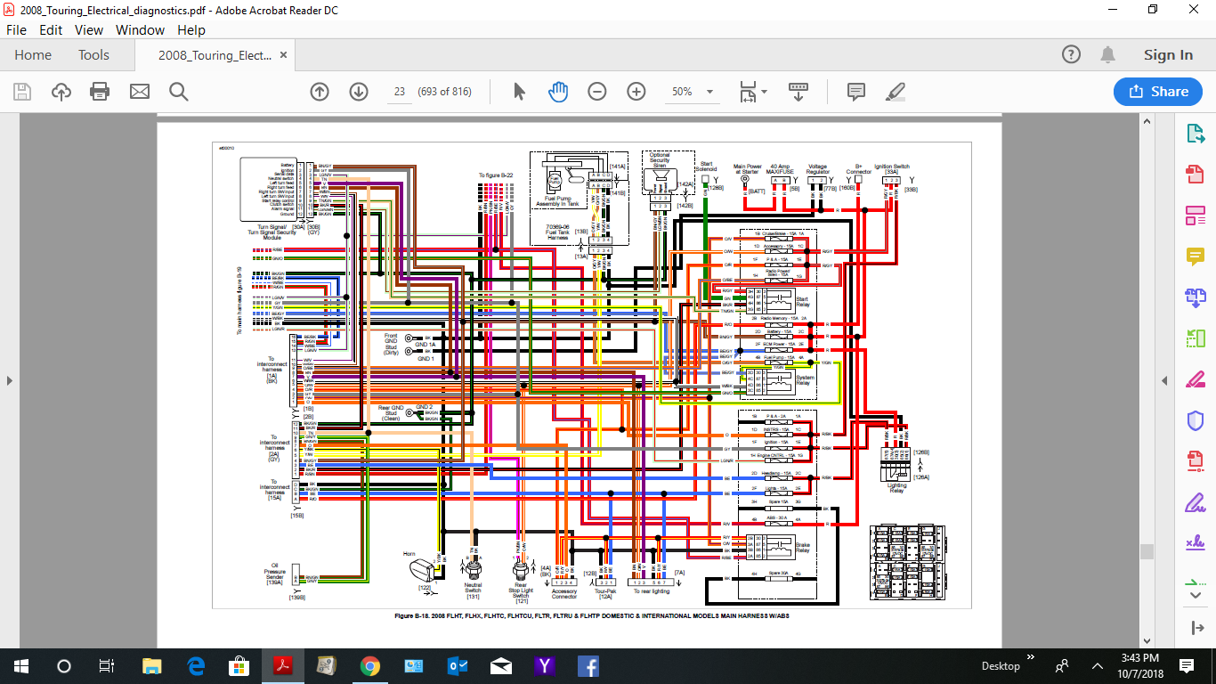

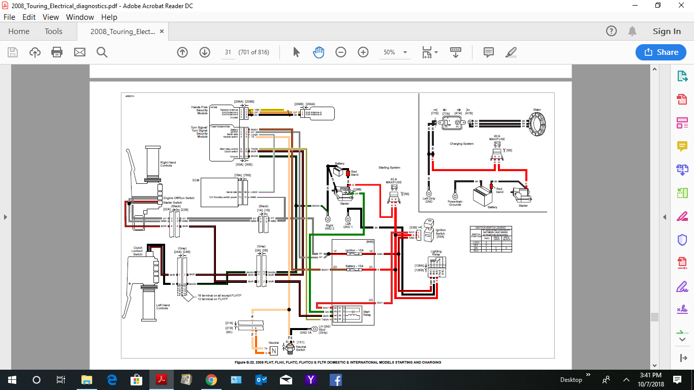

So I was riding and my bike turned off. I pulled over safely, but now she won’t turn over. Power to the dash and headlights and tail lights work; however the turn signals don’t work. I’ve replaced the ignition fuse several times, but it keeps blowing; I’ve replaced the ignition relay and the turn signal module. However, the bike still won’t turn over. The diagnostic reads U1064, (TSM to ECM issues) and there’s a red key displayed in the dash. The battery is about two months old, the terminals are tight, but it won’t turn over. It has 7500 miles, so there’s that. Any suggestions would be greatly appreciated. Ride safe!

Izzy welcome to the forum from UT.
When does the fuse blow? As soon as you turn Ign on or after you turn the kill switch to run or when you push the start button?
When you turn the Ign on the Ignition fuse gets power. The power goes to the TSSM, Data Link Connector, ABS module and to the Engine off/run switch on the right hand controls. Turn the Engine off/run switch to run and the fuse supplies power to the system relay, and if it's working you hear the fuel pump run for 2 seconds, it also supplies power to the start button and to the ecm to let it know the switch is in the run position. so depending on when the fuse blows will give you an idea on where to start looking for the problem.
If you or someone has changed handlebars or done other mods should be considered.

I too suspect the Right hand controls but would pull the fairing and check wiring at connector 22A before I opened the housing. Check Grey to grd for continuity on 22A, if open disconnect TSSM and ECM and check 22B Grey to ground with Ign fuse pulled. Things are tight in the housing and if you do need to replace a switch take a few pictures with your phone of how the wiring lays in the housing before you take anything out.
