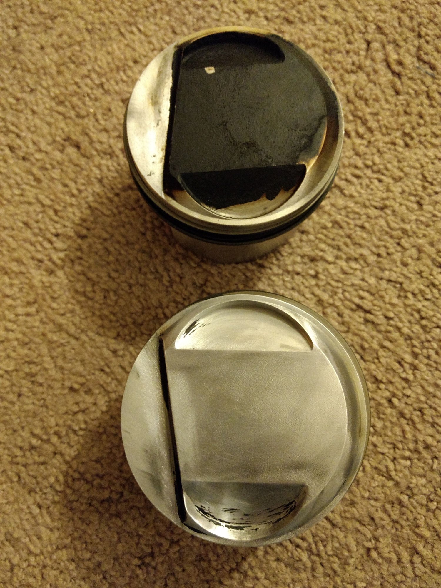

Okay just so you know the Pistons need to be installed properly. If you look in this picture...

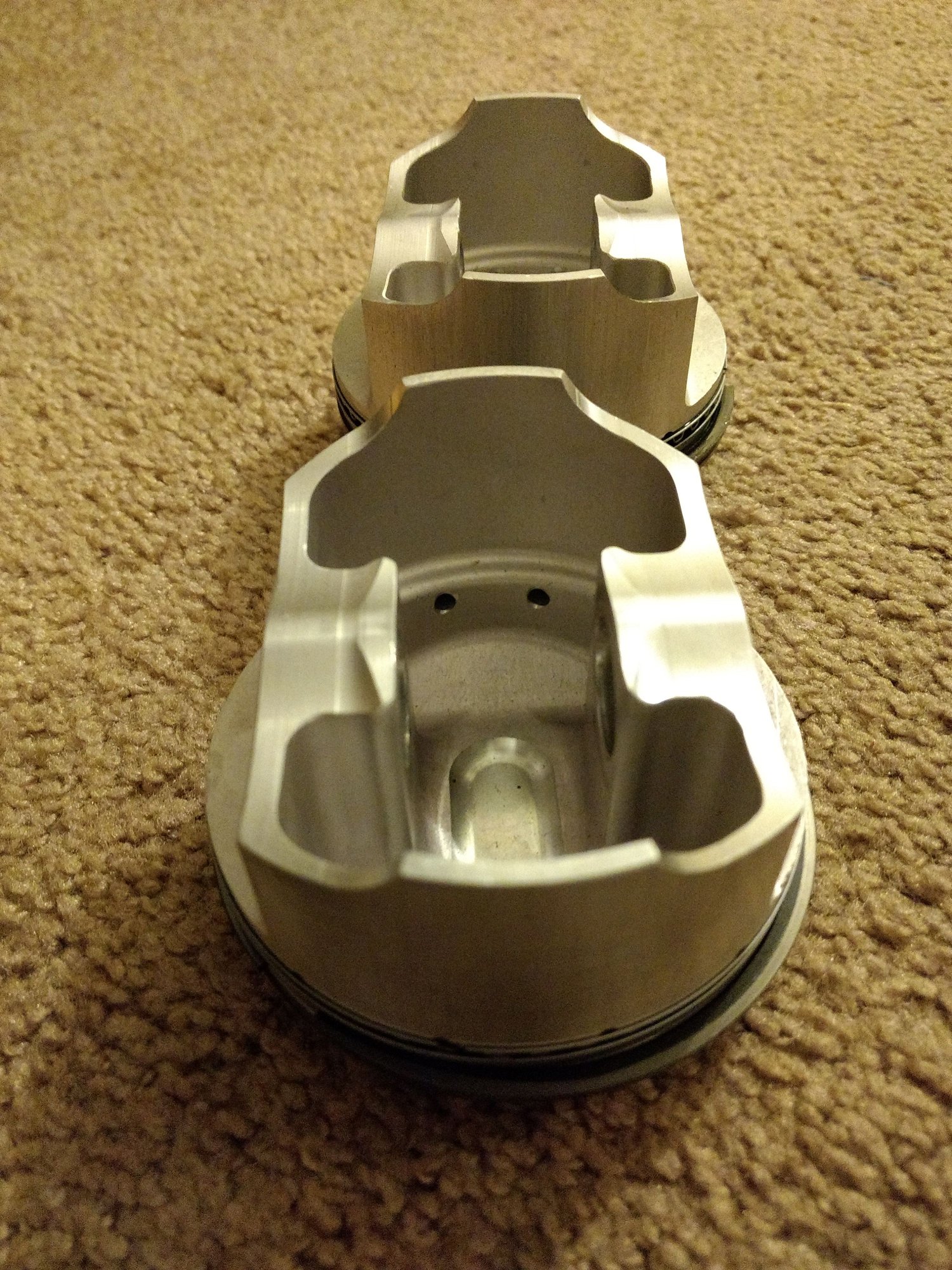

Notice the valve reliefs, their situated to accommodate intake and exhaust valve which would indicate front cylinder or rear cylinder placement... Now if you look at the next picture
you will see that there are no reliefs in the skirts. It is impossible for the skirts to hit the wheels with this configuration....
You will also notice in the first picture where the Dome has a straight edge on the left side, that is because the cylinder head combustion chamber is designed in the shape of a D, with this configuration the Piston dome can fit up into the cylinder head to raise the compression.
So either one of two things happened here. The Piston dome shelf (straight edge) was on the right side allowing the Piston to make contact with the cylinder head... Or the front Piston was in the rear cylinder and the rear in the front which at this point would not give the proper clearance for the valves to the valve reliefs in the Piston. Notice the difference size reliefs? And one more thing changing from the stock N grind cam to an EV27 would not cause any clearance issues.. It's a bolt in cam...
