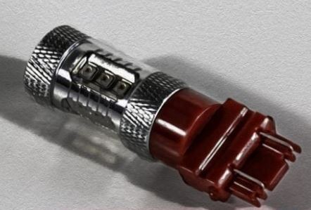

Originally Posted by jannie
I have a 2012 Road Glide Ultra. It uses a rear tail light/ stop light bulb, mgf. P/N 14407. I would like to install a LED bulb but cannot find one. Has anyone done this on this model? If so please send P/N and where you bought it. Thanks, Jannie
I installed this, it should fit your bike.
HARLEY REAR FENDER BRAKE SUPER BRIGHT REPLACEMENT RED LED 80W 1200 LM
https://paradiselightsllc.com/shop/h...d-80w-1200-lm/

socalmotogear.com part #3157. LED plug and play rear red LED taillight. Its like $30 and very bright. Mine worked great, easy install.

My last bike I dropped in a 3157 red LED the same as my Jeep. Brighter than stock, though not as bright as a BAL or CD tail.
It's not a special bulb.
