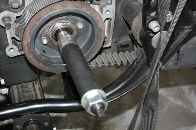

Originally Posted by hardheaded
It looks like the primary bearing inner race has walked inward and took out the seal. Be sure to check the main drive gear bearing while in there.
The puller is probably not going to work on that walked in race. It has to get in between the race and the transmission shaft lockplate and nut. I ended up cutting mine off.

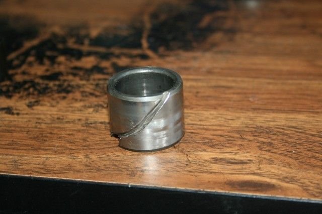

I remember reading a post on the forums a few years back that gave a good how to procedure on how to cut a walked-in race off using a high speed grinder. I tried a Dremel tool with cutting disks and it went pretty fast and came right off with no issues. I have not cataloged all the photos of my project build yet, but I found these...
I put a hose clamp on the transmission input shaft right up against the race to protect the shaft from any accidental damage and did not try to cut through the race, only enough for it to crack from the natural stress. The curving is how I kept from the cutting disk away from cutting the nut and lockplate. I could not cut it all the way to the lockplate but it was enough for one hit with a chisel to crack it and it slid right off.
I bought both race tools and ended up only using the one...and probably could have done it without either.
