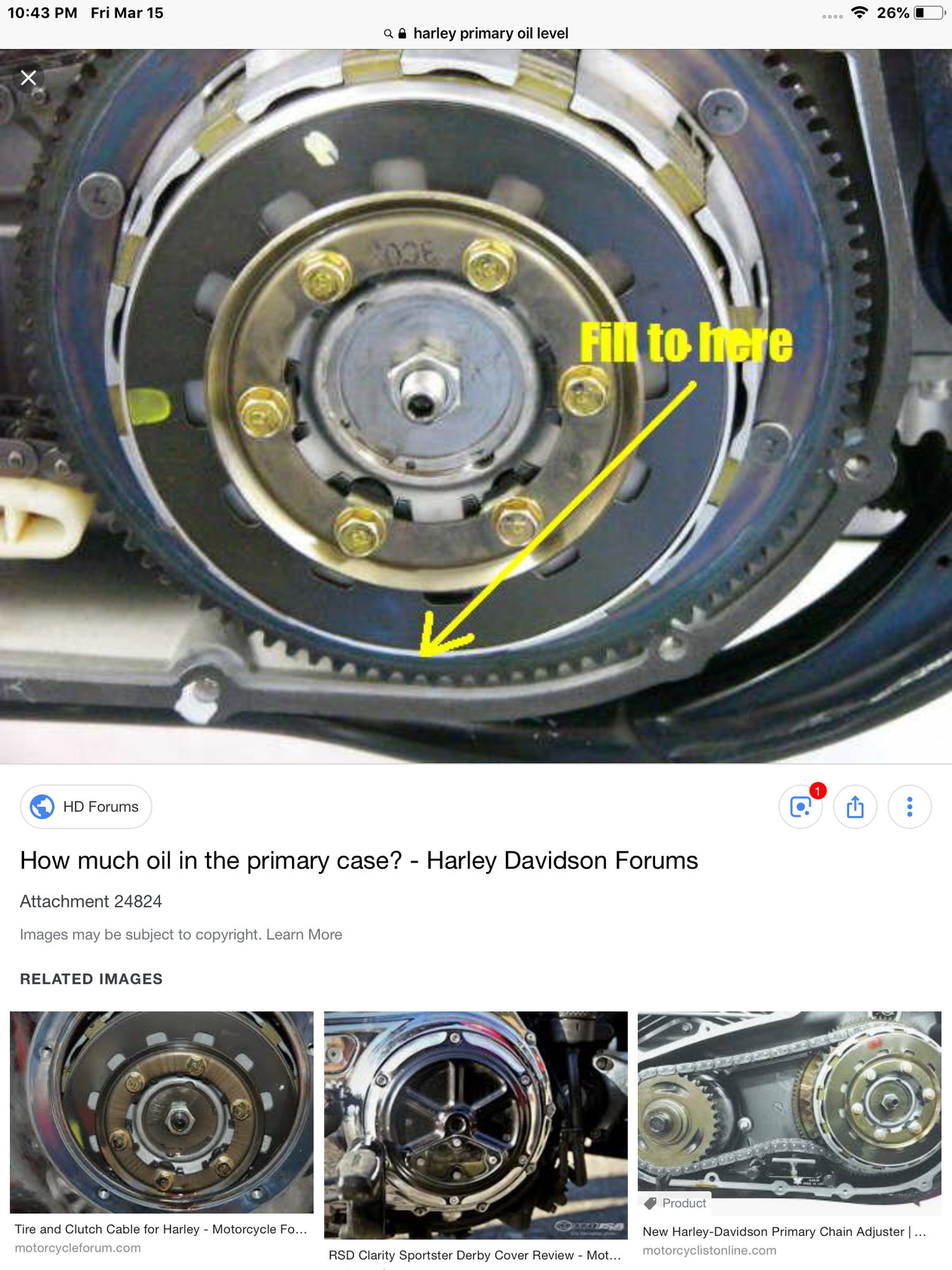

The oil does not fill to the derby cover opening. That would be way too much. With the bike straight up if should cover some of the primary chain but not much more.

According to this picture it just touch’s the starter ring gear on the clutch basket. Which is about where 32 ozs hits mine. You will barely be able to see it below the opening.

Then I should be ok.
thanks

I put 38 ounces in my primary... or until it comes to the bottom of the clutch pack. You may not get all the oil out so 38oz put in blindly may be a tad bit much. If you cover the clutch, you may (and that is a slight may) experience some clutch slippage. I had the engineer at Energy One Clutches tell me not to use Syn 3 in the primary. The synthetic has components to make it more "slippery" which can and will affect the clutch operation. I use Amsoil in the engine and HD Formula + in the primary. Just to make sure.
Again oil level to the bottom of the clutch pack.

You will use a little bit more fluid when you do service that requires the removal of the outer primary than you will on a standard fluid change. On my '08 the Factory Service Manual calls for 38 oz for a standard fluid change and 45 oz after service that requires the outer primary cover being removed. On the older models like your '04 and my '06 the standard fluid change requires 32 oz. You are going to need a little bit more fluid than that to bring that level up slightly higher than the bottom of the starter ring gear as was mentioned earlier. This isn't brain surgery, grab a flashlight, a couple of oz one way of the other isn't going to make a huge difference. Much more than that, however, and it can have an adverse effect on the operation of your clutch.
