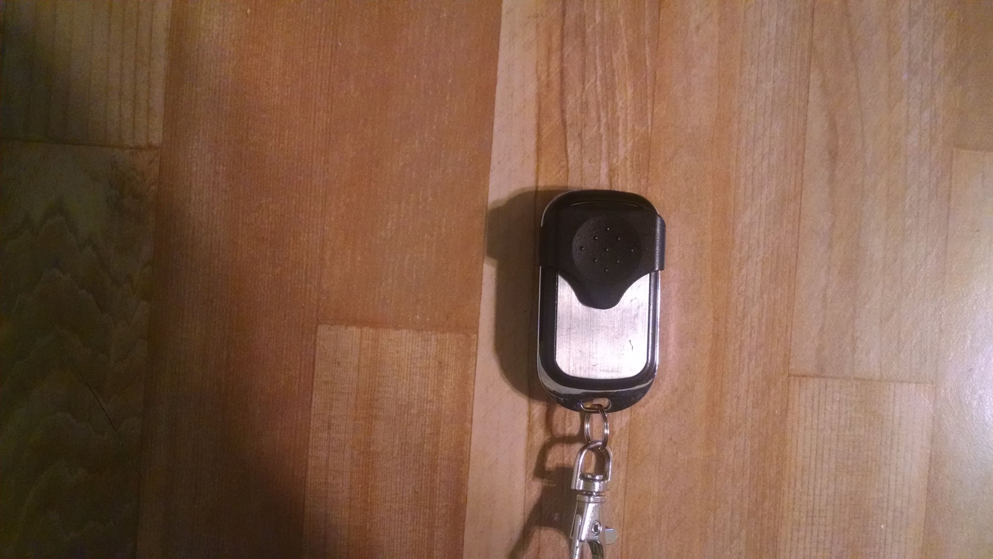

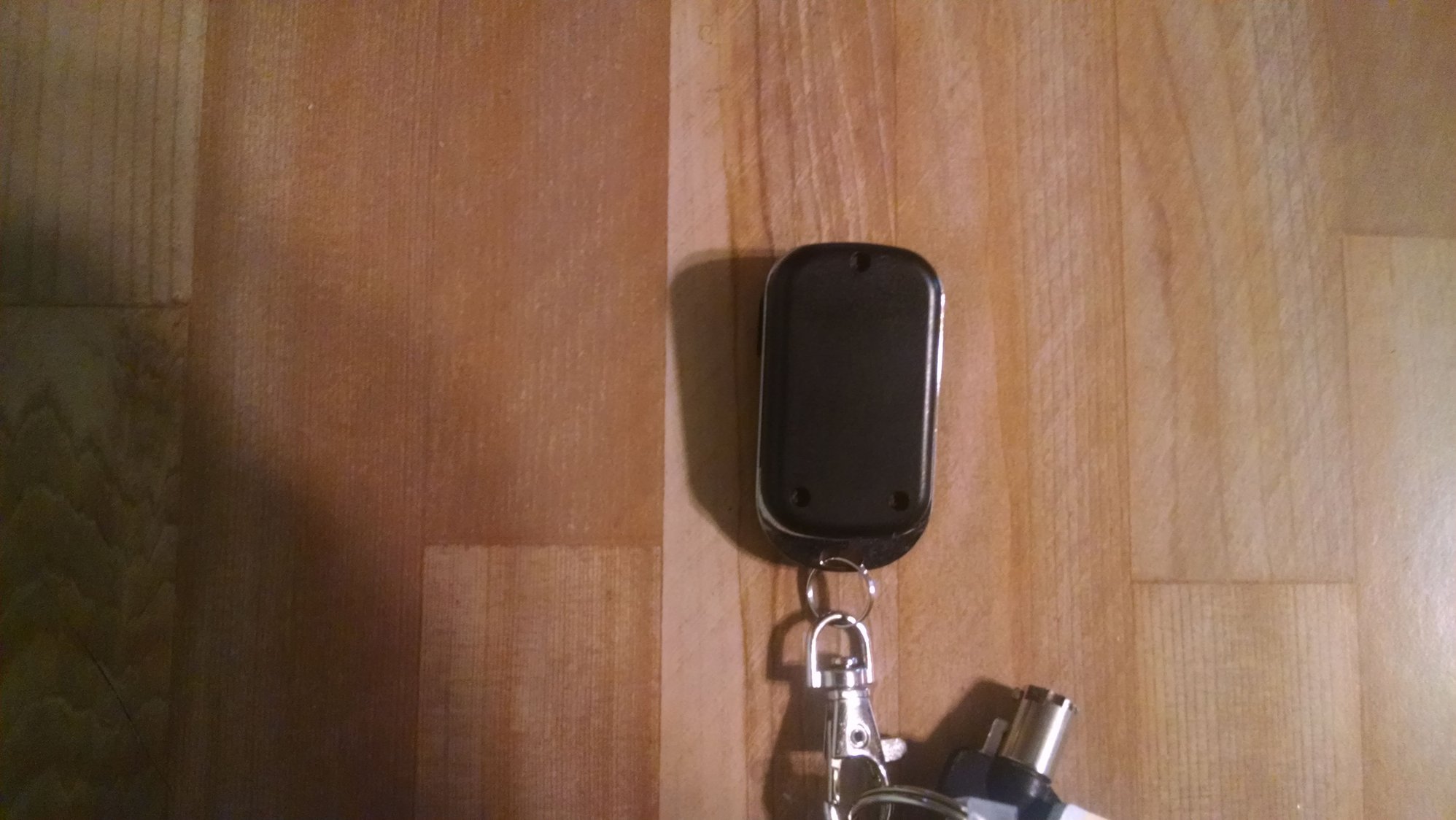

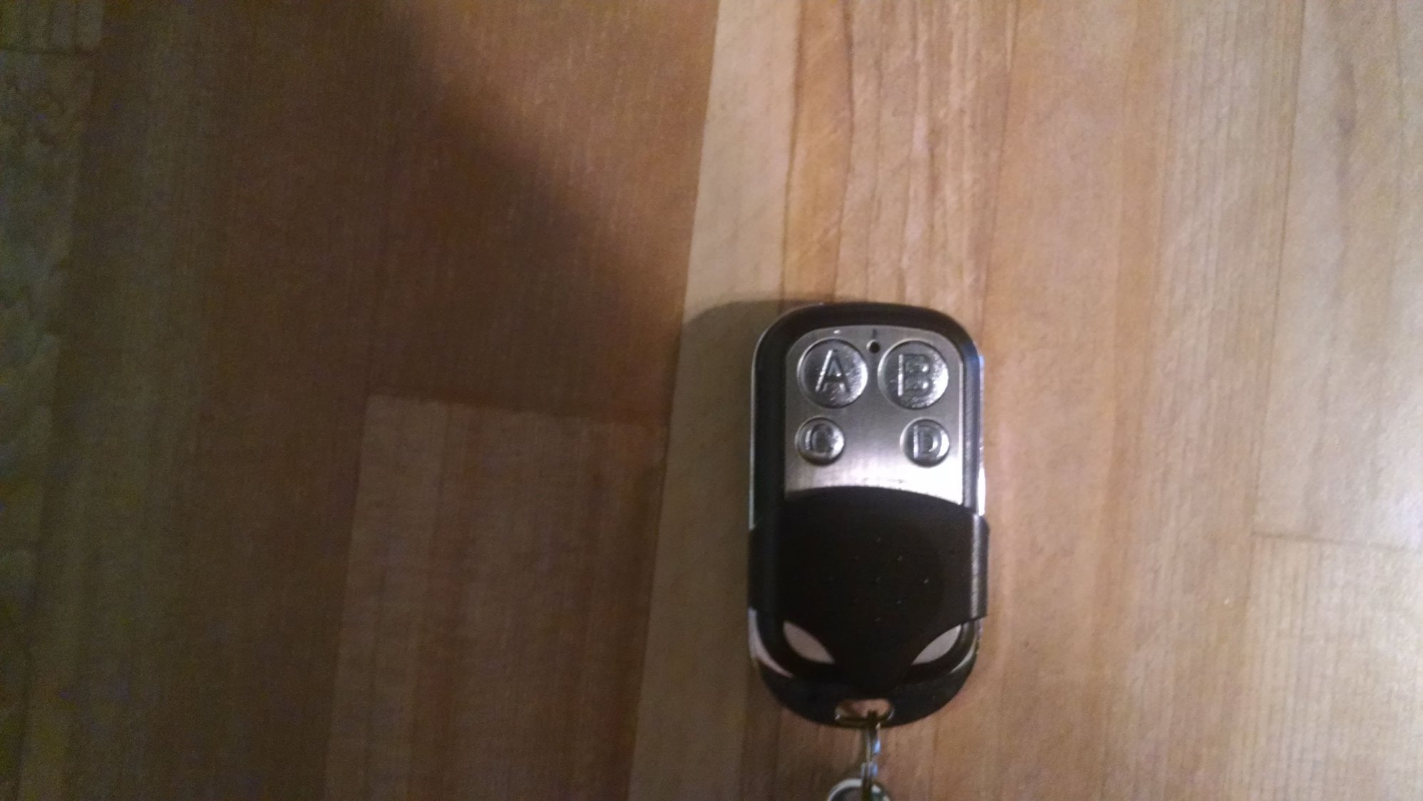

Hi guys,
I got a 2011 limited used that a PO installed aftermarket LED lights. But for some reason they come on by them selfs and drain the battery. both times the bike is in the garage and I am wondering if a Neighbors garage door opener is causing the lights go come on .
Is this ever possible ?
I have no clue on the manufacture of the lights and the remote I got with the bike looks like a universal remote with 4 buttons on it ( A,B,C and D )
Any of you guys run into this problem ?

Got a pic of the remote?

Button guard up
Button guard down
Back side
Controler
Controler
Here are the pictures of the remote and the control box, It is wired straight to the battery + and - .

The Leds have multiple colors, fade and flash patterns that can be controled by buttons A,C and D. it seems that button B only controls on and off.

Looks like a Joe Florida setup, like I have.
download the app, and you can link to the light controller and set the lights up the way you want.
http://www.joeflorida.com/
if they are coming on on their own, you’ve got one of the wires touching a ground.
