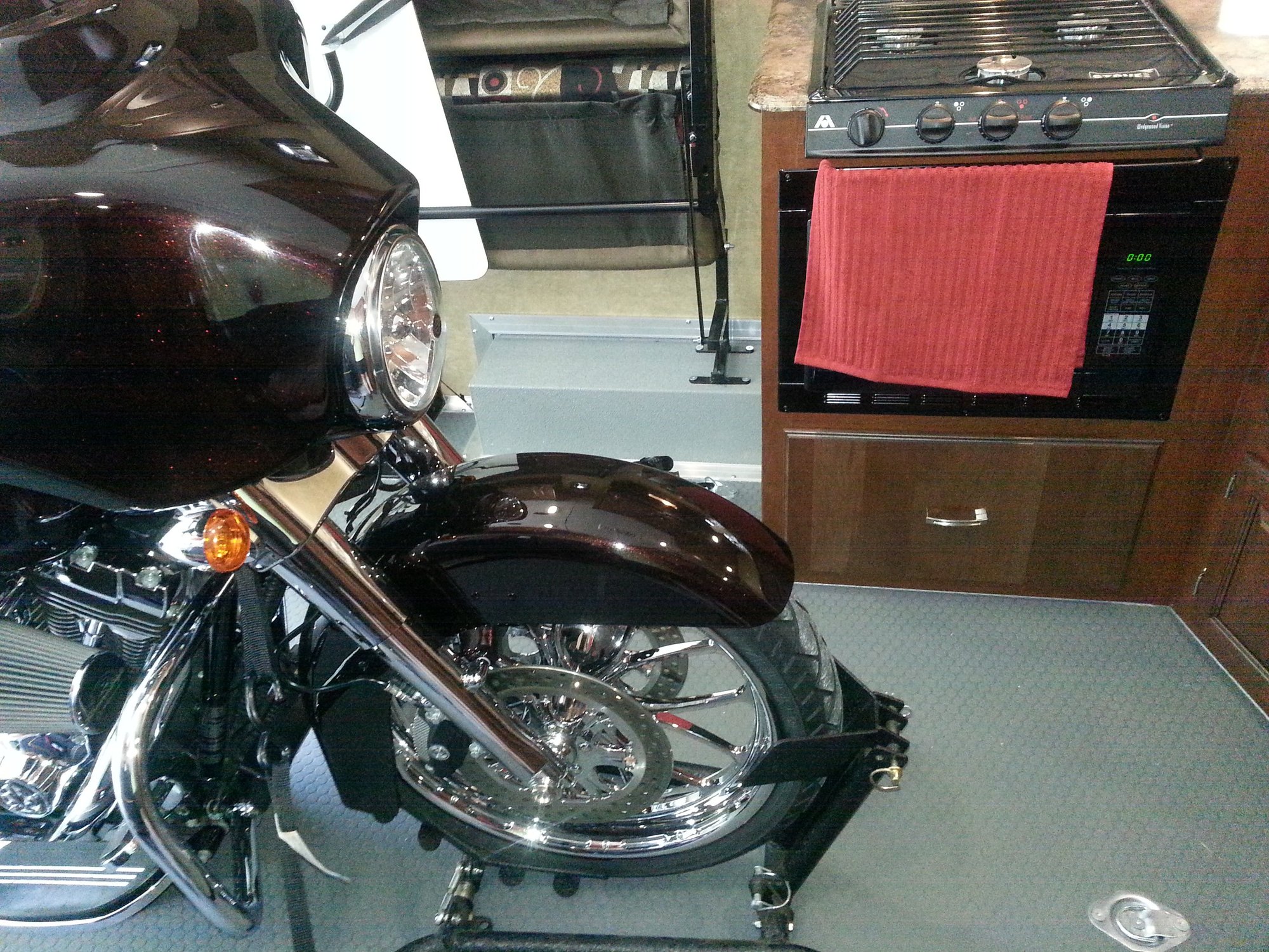

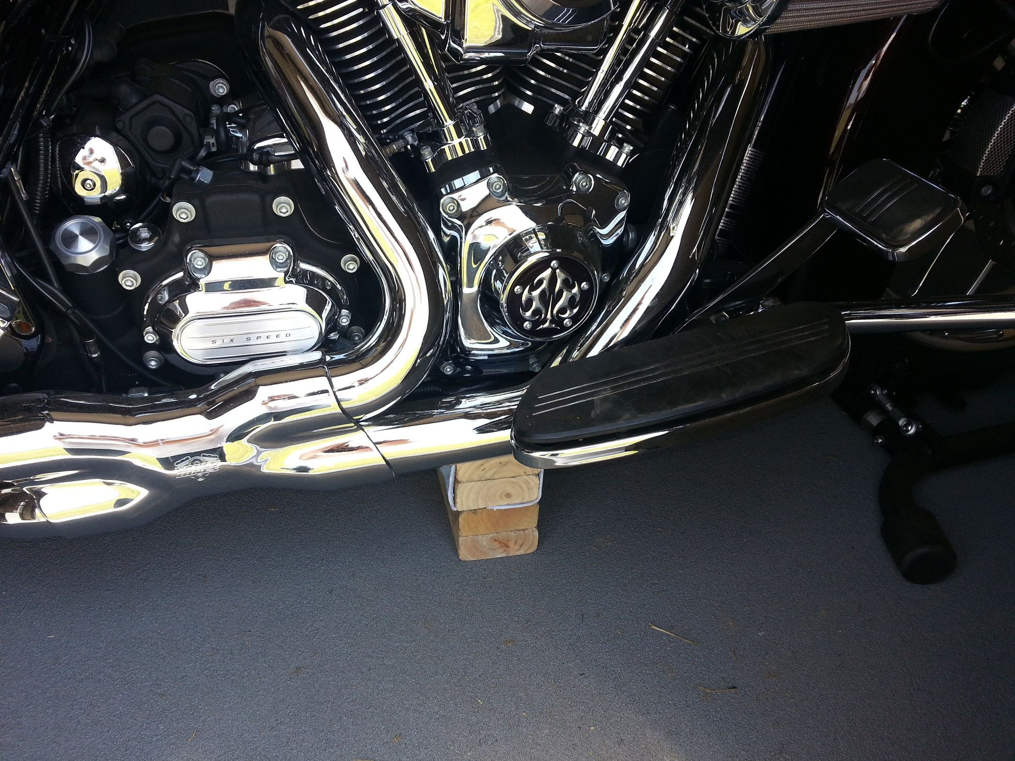

Home made block of 2x4's to cinch frame down onto, so no suspension travel or blown fork seals, two front soft straps around crash bar and frame, so no bent forks, two rear soft straps to the passenger floor boards, Baxley chock (best chock available) and Mac's ratchet straps (best straps available) .... !!!! .... absolutely no movement after thousands of trailering miles and easy one person loading.

Using the 2X4 or any means to block the frame, this keeps the bike suspension from moving at all and thus will eliminate your straps from loosening due to bike bouncing

My experience is that a strap above the fender on the lower front suspension mount near the triple tree is ok if using a chock to hold the wheel strait while the bike bounces on its suspension. But because the bouncing causes slack in the tie downs on each bump, the front wheel is more secure when strapping down tight at the fender mount to prevent any possible slack during bounces. As for the rear, these bikes will hop around on bumps if not tied down. At least one tie down to hold the bike strait, but two are better to hold the rear wheel solid to the trailer.
If a tie down is attached or laid across any painted part of the bike that bounces, like the frame or tank, it will get scuffed as the straps move with the bounces. I've not tried it, but the suggestion here of strapping the bike down tight on 2x4s would prevent the bouncing that scuffs the paint.

The first time I used a frame block like that it worked its way out allowing the straps to drop limp to the floor. Miraculously, the Condor front wheel chock kept the bike standing up perfectly! True test (unwanted) of the Condor wheel chock system. Great product!

One helluva good looking bike!

Exactly what happened to me. I wonder if rubber instead of wood , would have worked better?Or maybe a block of wood sandwiched between two slabs of rubber. Condor is a great chock!
