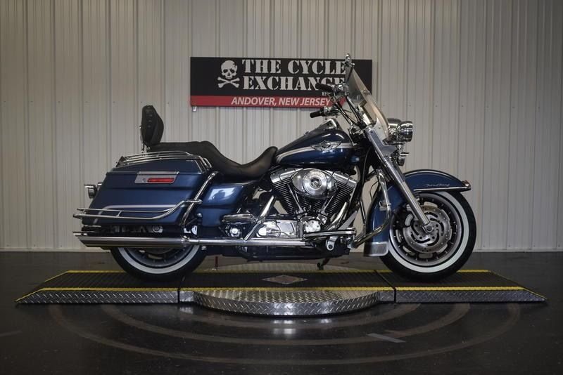

Hey all,
This is my first post here and I’m just looking for some advice/ answers to some questions.
I found an ‘03 Road King 100 yr anniversary with 7k miles. I am trading my ‘18 Sportster Iron 1200 for it. I got it for an even trade out the door.
I use my bike to commute during the nice weather & take trips with my girlfriend & club where a majority of guys have Street & Road Glides, and the 3.3 gallon gas tank is a little inconvenient.
I haven’t picked the bike up yet but is there anything I should I keep an eye out for that particular year & model?
I’m purchasing the bike from The Cycle Exchange in Andover, NJ if anyone has had any prior experience with them.
I appreciate all info & advice, thanks in advance!
