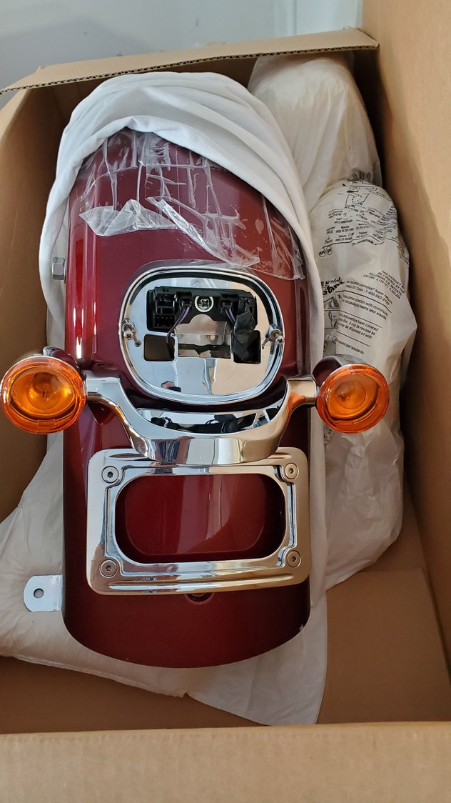

Want to put the Harley curved license plate frame on my 2021 RK. Does anyone know if it'll fit? The mounting holes look the same on the RK lighting bar as the Street Glide, but Harley doesn't list it as an option. Anyone do it with a recent RK?

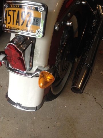

Not sure what the bracket looks like on a RK so this reply may be moot, but the curved frame does fit on a Softail Deluxe. Install did require opening the tail light assembly:

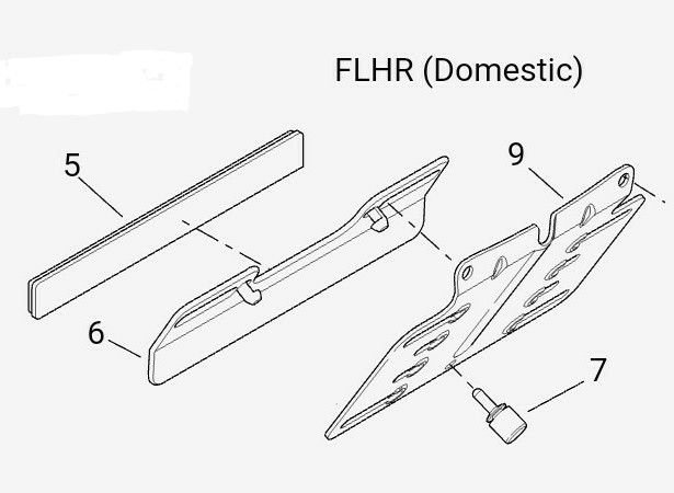

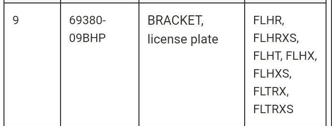

From my research it appears that Kuryakyn makes one but the reviews are spotty about the quality. Harley makes a curved plate but it states that it is for '09 RK's only. Part # 67900056. I looked up the stock plate frame that came on the '09 (69380-09BHP) and it's the same as '10-20 ('21 not listed yet, but it's the exact same bike as 2020 except for the clutch cable). This seems to imply that the mounting holes are the same under the turnsignal bar (as they use the same license plate holder) and therefore the curved plate for '09's should fit newer RK's also. I'm gonna order one.
