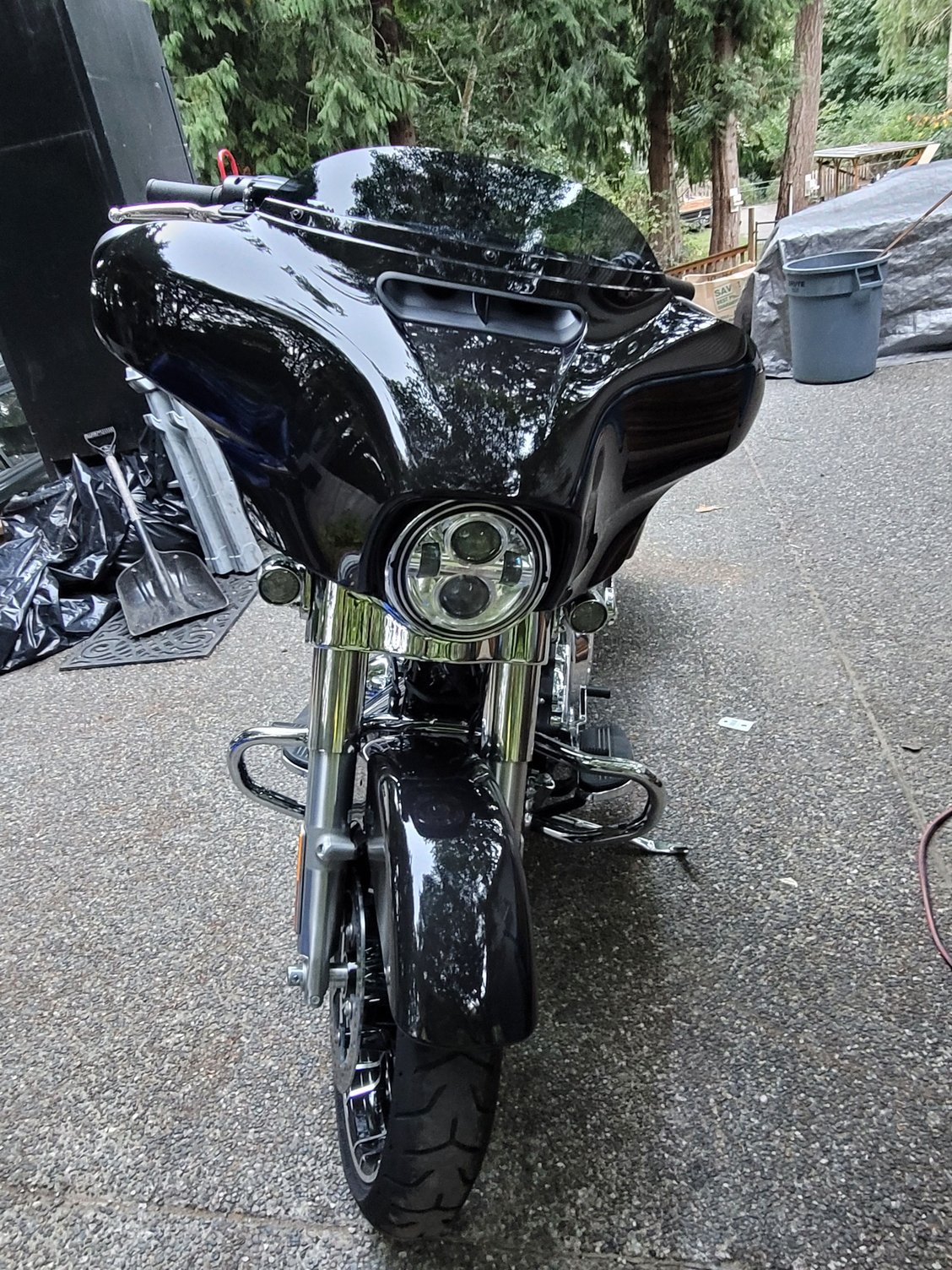

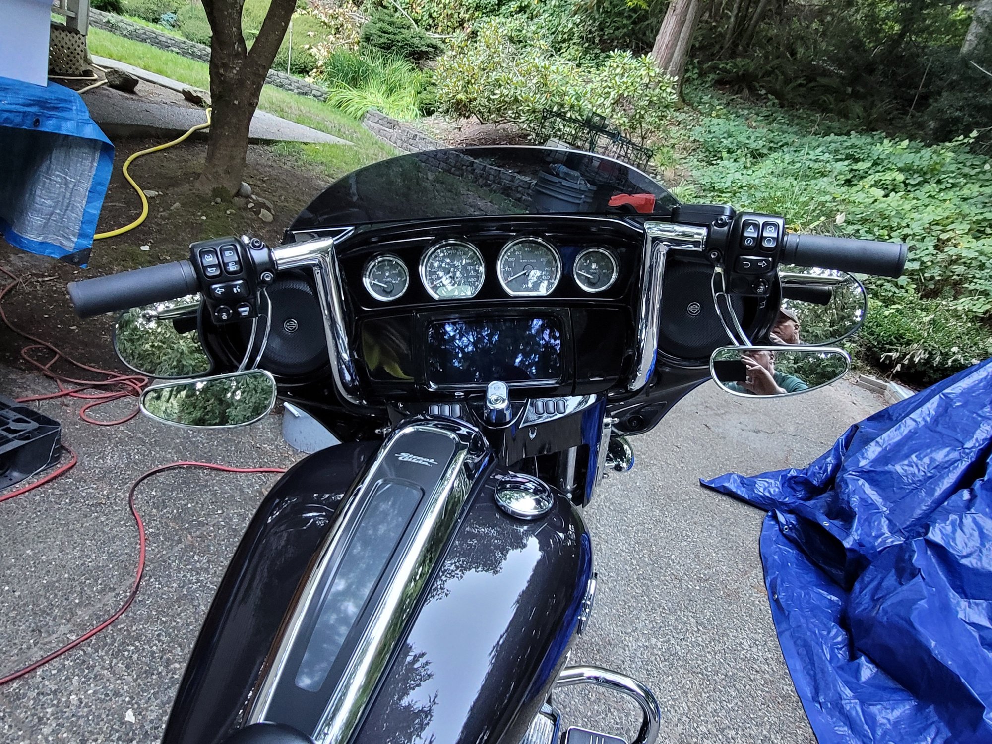

Looking at installing 12" LA Choppers Twin Peak bars. Cant seem to get a straight answer on whether or not I will need to extend cables, brake lines, etc. Anyone change their bars on a 2021 with cable clutch?
2021 Street Glide Special
Got my new bars installed. Stock clutch cable and brake line. Had to add extentions for wiring.
