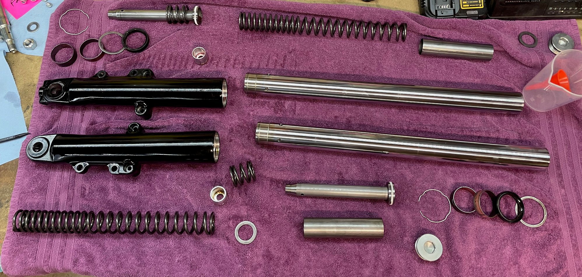

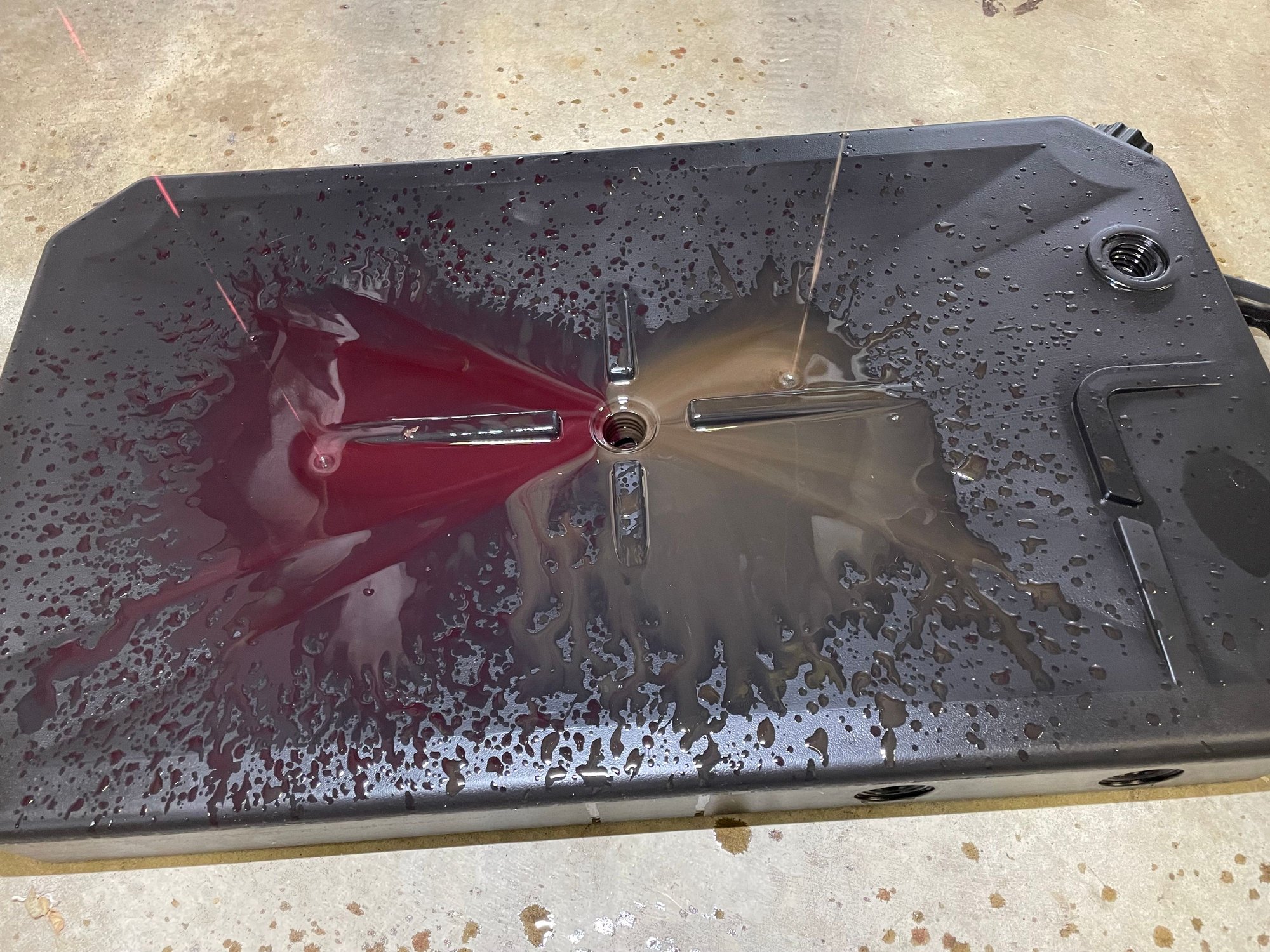

Hi. Bought a brand new 2020 FLHTK w/ 2 miles in February of this year. Now has 6,200 miles and I'm putting in a set of Legend AXEO fork cartridges. I drained the factory fork oil from each fork and saw this:
The right fork had clear bright red fork oil. The left fork oil was brown and completely different color.
At first I thought maybe the brown oil was contaminated. After splitting the forks that doesn't seem to be the case though. Neither side shows much wear or has any "shavings". Far as I can tell, MoCo used two different kinds of fork oil in each fork. I find this really odd. Anyone else seen something like this? Thanks!

The off colored oil (non red) looks to be contaminated with moisture.

Thanks for the reply! Didn't think about moisture. So the red oil turns brown when exposed to moisture? I didn't notice any leaks in the seals prior to disassembly.

Not on this bike. Both fork internals are exactly the same.
