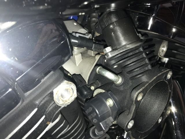

So did about 300 miles on Sunday - about two miles from home my throttle cable broke - no biggy just put the hazards on and limped back at idle in first gear to get home.
My question is - I havent had the backplate for my air cleaner assembly off in years - when I removed it to get at the cable connections on the throttle body, I noticed a small silver 90 degree elbow attached right in the middle of the throttle body (See pic) I dont remember ever noticing it before, and it doesnt have a hose attached to it, nor could I find a disconnected hose anywhere. It is basically unconnected and just sitting there. Any one know what it is and if it supposed to be connected to something?

That's the port for the charcoal canister on the California models. It should have a cap on it.

Thanks!!!! I started hunting microfiches and couldn’t find the part!!!

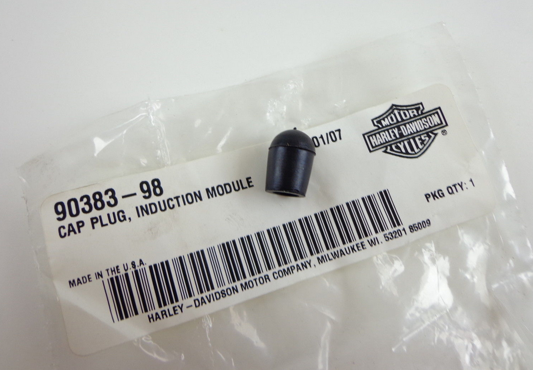

Originally Posted by 702
You can find a vacuum cap to fit at any auto parts store.
Its only three bucks and the local HD has them, I tend to go OEM where I can.
