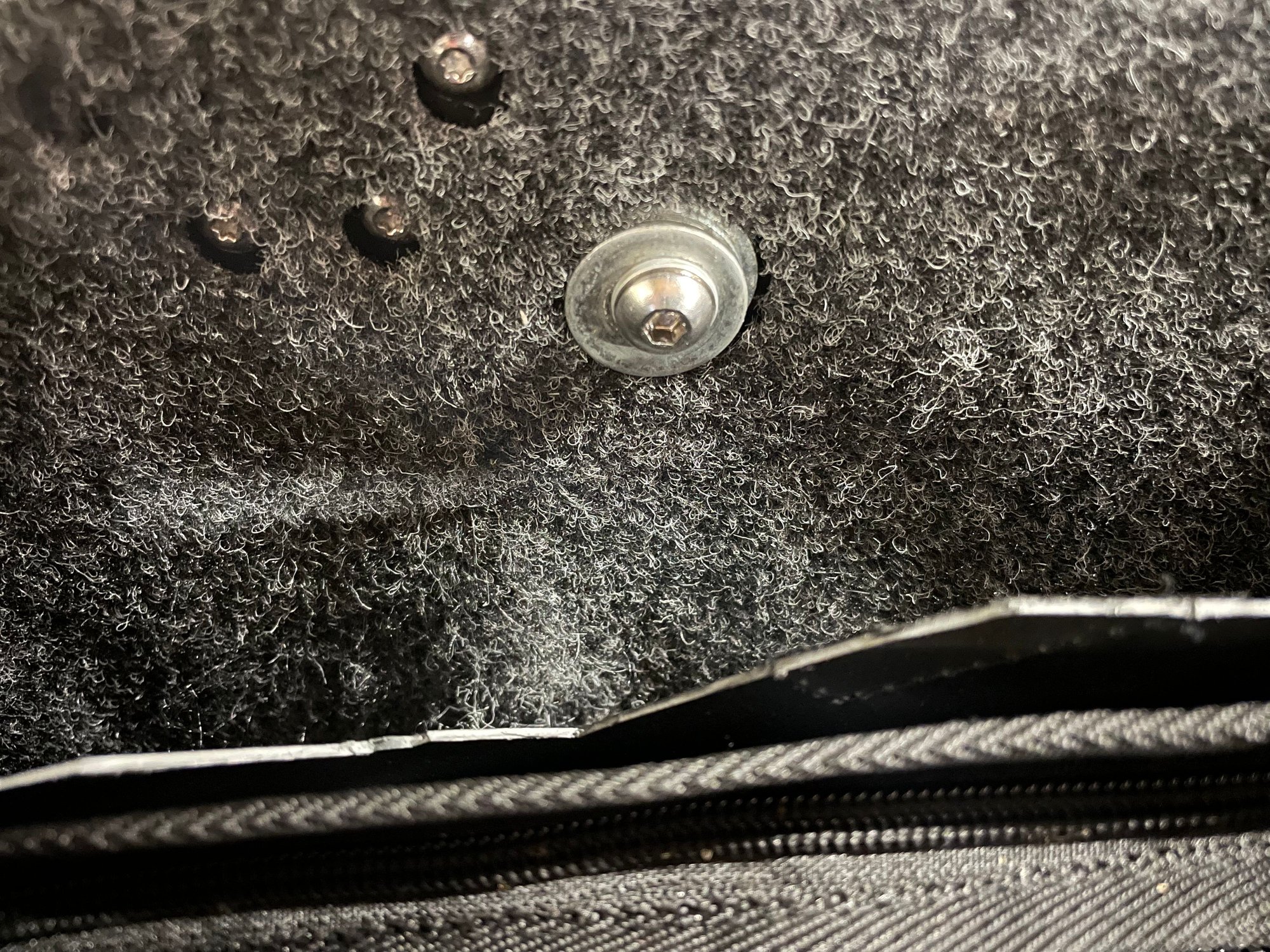

This is my solution. A 5/16-18 stainless steel button head screw, lock washer and a u-bolt, also known as a fender washer. I use this on the rear attachment and the dzus on the front. This sticks out less than the dzus fasteners and I keep a small alien wrench in the bag I keep my shock air pump.
I’ve never had the dzus fail in 10 years so they are pretty good. HD must have changed something on the early Rushmore bags because they were failing and it was a recall. I had a coworker that lost a bag on a 2014 Streetglide.
