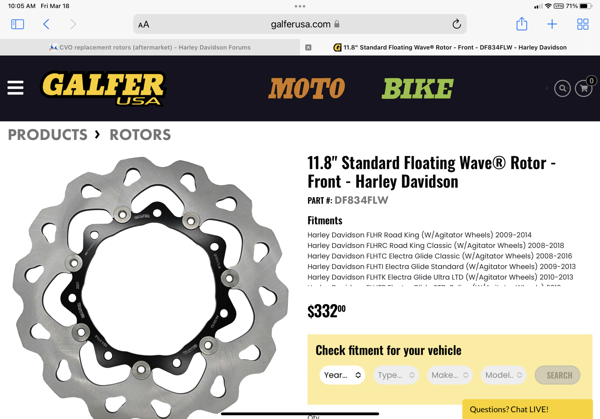

There are 7 bolt rotors out there for the “Agitator” wheels. You would need to verify if they are indeed on the same bolt circle as yours.
https://galferusa.com/moto/product/97030/DF834FLW
Hi thanks, Galper was not sure those would work and if they did, they do not have a "floating" option.
Honestly, there is no point in spending $600.+ just to do a standard size rotor swap.
$60. on better pads is the best option.
Still searching.
Still searching.
yeah, those are “floating” rotors, but use the wave spring to provide it. Not what I really consider a “true floating” rotor
