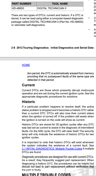

I attached a picture of the diagnostic codes on my PV. The voltage seem to be running a little high on my Voltmeter gauge (15+) before it the engine & battery light came on. When the lights came on the voltage on the gauge dropped below 12 volts. I have a regulator on order as of today. My question is the other codes in the picture lead me to believe I might have issues with the radio control switches. Has any one seen the DTC’s come in with low voltage?

if the battery is good fix the regulator then see if the codes come back.

The B codes shown are historic, do they come back once cleared?

I will monitor it once the regulator is changed out. Thanks
