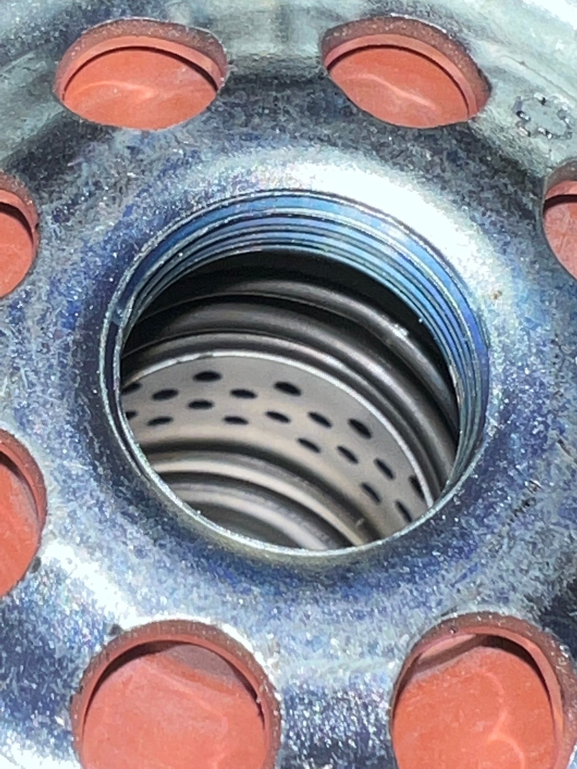

I called H-D Customer Care, at first, they didn't seem all that concerned until I mentioned that OP in St Louis had the same problem that I in Ohio had. They wanted the filter back to swap it. I explained that I'd taken it back to Adventure H-D in Dover, OH already & that I'd done an oil change ahead of schedule yesterday because I was worried the current H-D filter on my bike could have the same problem. I mentioned the filters being shorter than they're supposed to be too (3.5" being sold as the "New" 4" model).
I told them I took pics & had all the code numbers that were on the box in them along with a pic of the bad louvers. They were interested & wanted to see them, so they emailed me asking for them. I emailed them the pics of the new filter with all the numbers & the interior view of the bad louvers/holes. I included a pic of the interior louvers/holes on my old (bought 3/13/22) H-D brand filter that I took off yesterday which turned out to be good.
I guess we'll see what happens now.
I did the same this morning. They sent me an E-mail. Told the gal the entire story along with pic's. They gave me a ref. number and now it's in their hands.
Want to hear something funny ? Took my oil filter back this morning and received a store credit which i blew on some brake fluid. Anyway the parts guy brought out another filter to compare my filter to and it was missing the rubber gasket. We both had a good laugh.

Did some quick checking and cross referencing.
The older twin-cam filter 63731-99A and the newer 63798-99A both cross over to the Baldwin B7434.
So you should be able to swap these filters without any problems
My 63731-99A filters have round holes. Admittedly, I haven’t bought any in recent months. Just something to consider.
A shot of my filter:
