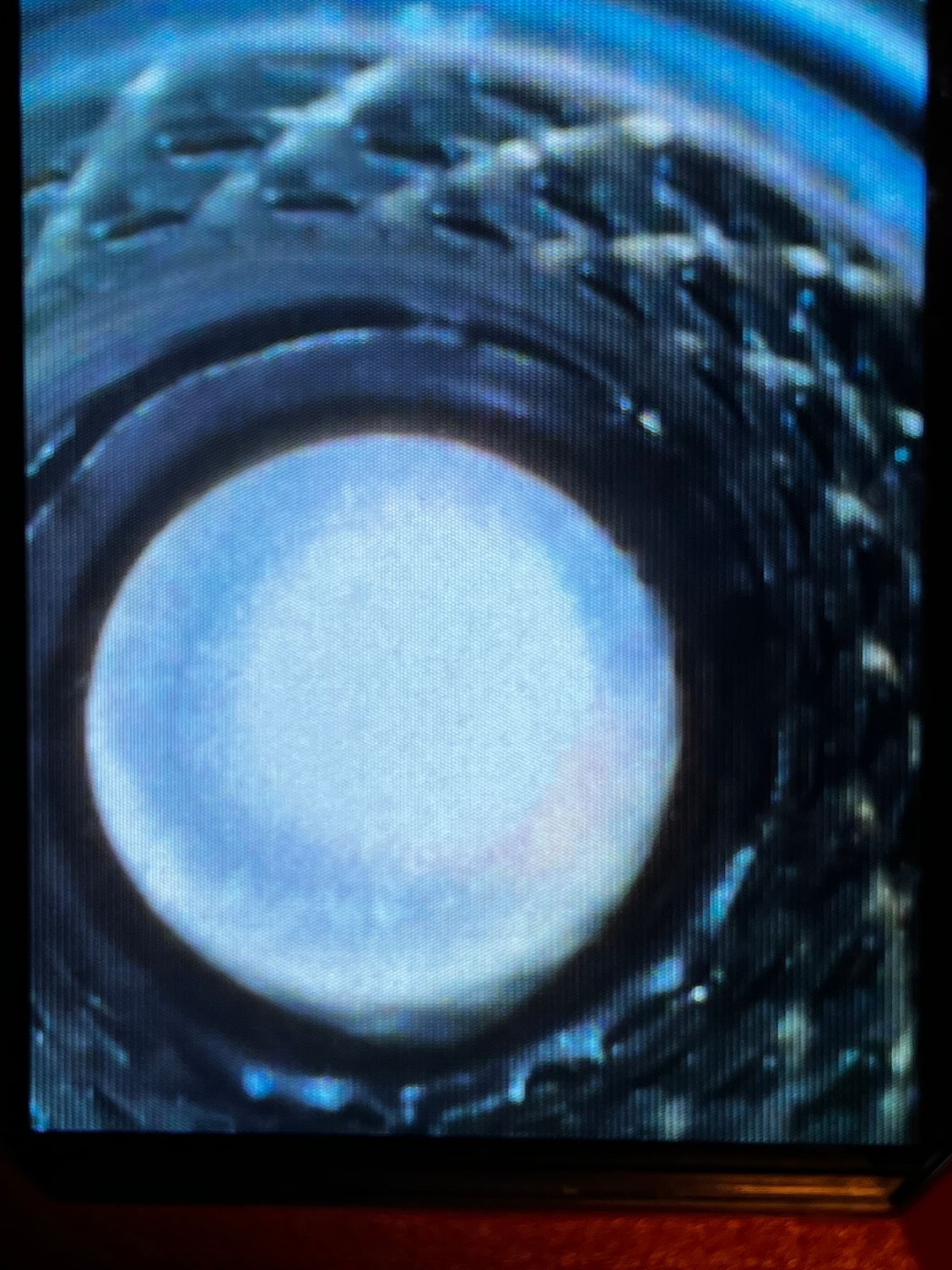

I have never in my life had such a hard time taking pictures! I finally had to use my inspection camera to get inside, I tried everything else. Unfortunately, the one I have at home doesn't have a camera attached to it, and I wasn't driving 40 miles to the shop to get the good one.
So, I took pics of the inspection screen, with my phone. Sorry for the **** pics, but it gives you an idea.

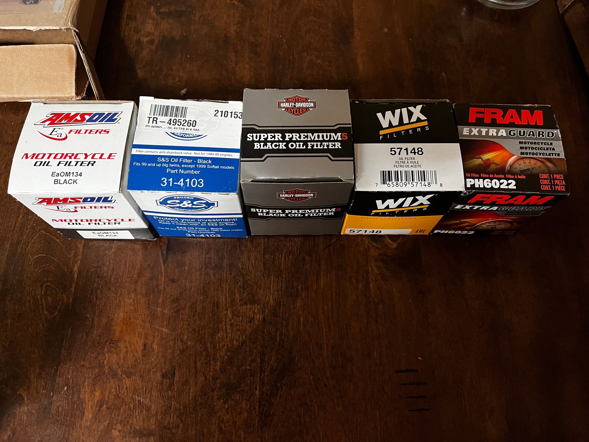

I had all these on the shelf for the bike, just got the Fram the other day to "inspect"
First I looked at was the HD. The louvers inside are definitely not uniform in their opening size, a few were as tight as OPs:
Next was the S&S, it also has louvers, and they all looked great. All uniform:
Next was the Amsoil. Mine did NOT have louvers, just holes in the core like you would normally see:
Next was the Wix, also just holes in the core:
Finally the Fram. Holes:
Yeah, that is GLUE or epoxy or some such crap on the bottom of the Fram. I have long contested that Fram is junk.
