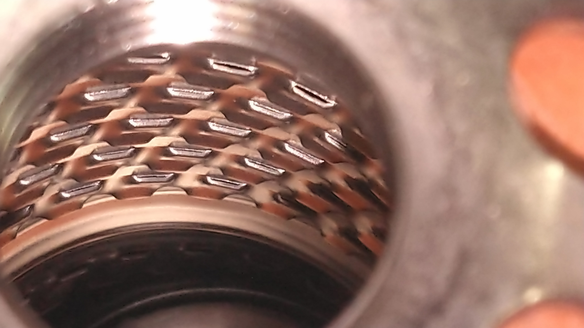

There’s nothing wrong with louvers on oil filters if they are formed correctly. Check out the link below on bobistheoilguy about louvers on an Amsoil filter. Good pics and discussion about it.
https://bobistheoilguy.com/forums/th...ilters.356961/

After reading through the bobistheoilguy thread I decided to check my brand-new HD oil filter.
Well guys, I'm going to stay the hell away from HD oil filters for quite some time.
This is wholly unacceptable for something that costs as much & is billed as a "premium filter". I'll be calling the dealer & returning it.
I guess I'm doing my oil change today (my Road King currently has an HD filter) & I'll be checking the filter that is currently on my Road King when I take it off too.
Who knows when this idiocy started.
XL pic so that even phone/tablet users can get a good view
This is exactly what i am talking about. This looks like it could certainly restrict the flow.
Instead of complaining about it on a forum, why don`t you send a note and pics to the MOCO and tell them about the issue?
We can`t fix the issue, but they certainly can.
We can`t fix the issue, but they certainly can..
I am not complaining ! i was investigating the issues and maybe problems with the new designed filters i saw with a new filter i bought. I hope this thread has opened a couple of eyes to what HD has done with them. You can make your own choices with this information. I will be using s different brand of filter for my next oil change. I will voice my option to HD next week. Not that they will do a damn thing as long as they are making more money on these new filters.
I thought this was a very informative thread .

Some of you guys should really go read the bobistheoilguy link I posted. It was stated on post #20 that after Amsoil was contacted “they were very concerned and wanted the filters back.” So no, louvers that are partially closed is not normal/acceptable.
