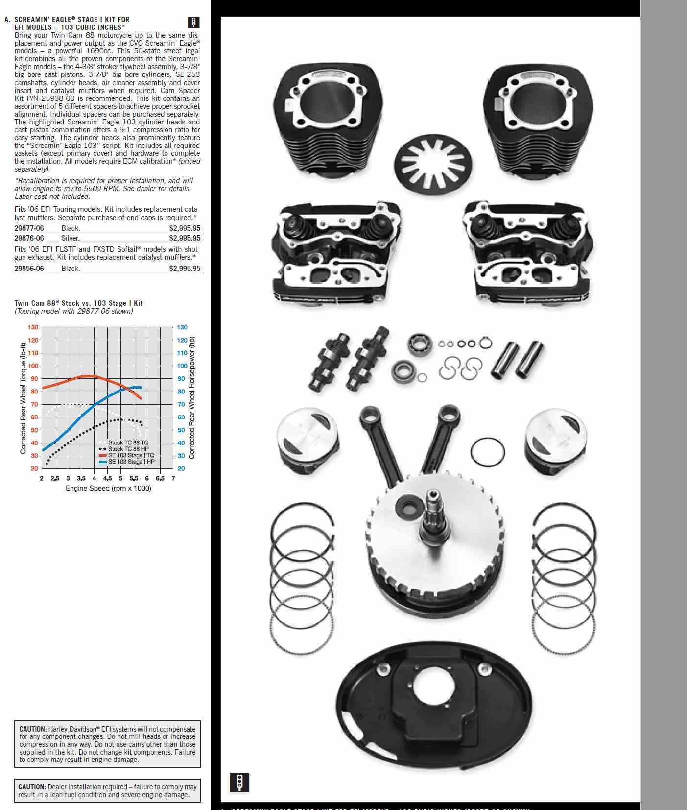

Well I split the difference and found a lower mileage 2005 RK Custom. Been well cared for by the looks of it. I have a question about it that previous owner couldn’t answer. It has a SE kit on it. converted to 103, Zippers 2 to 1 exhaust. Oil pressure warm at idle is about 30 and cruising its near or at 50psi. Tuning software was included. It feels pretty tame, or at least very driveable just cruising around town so I assume cams are pretty mild. Anyone recall in the years shortly after 05 what sorta things came with that kit? I do know it was done before 2011. Only thing I can’t verify is inside the cam chest yet as its still miserable here to work in unheated garage.

There are a number of kits back then.. Are there any badges on the cylinder heads?

From the 08 SE catalog. It is a mild build.
