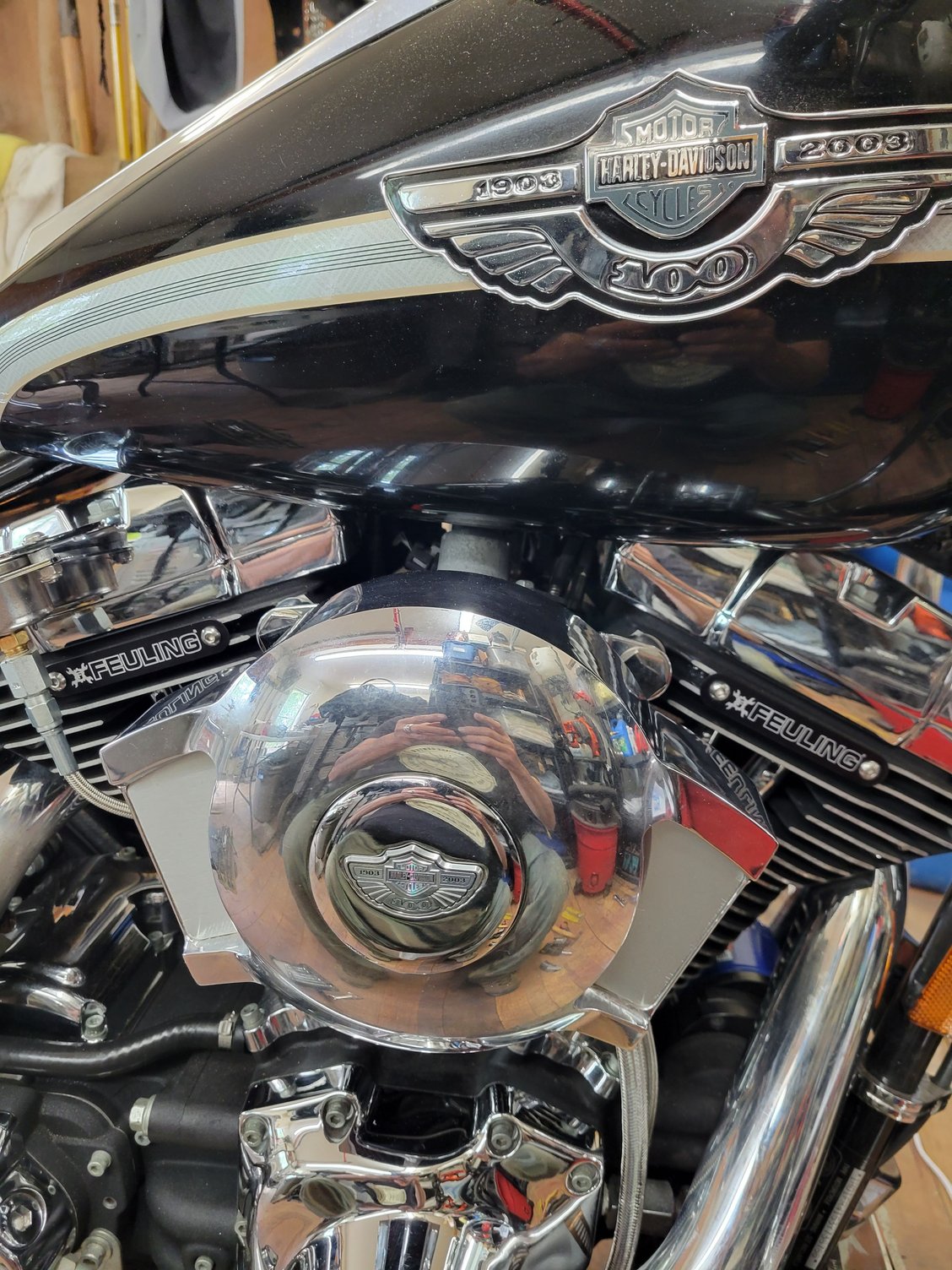

Thank you for the info!!! The cam chest is a mystery till I open it. Thats my plan. All I know is it was done to bike pre-2009. I would hope in doing all that work the bearings were upgraded, seems foolish not to. I am hoping I get a good surprise when I open it. Like gears maybe!!! Will be a while, garage is too cold. FYI bike has 15k miles. I was watching the oil pressure and saw that 30psi idle and 50psi hwy and was thinking upgraded pump at a minimum. Honestly in driving it and looking at the “claimed HP and TQ” thats exactly how it feels. Pretty good grunt down low but sorta so so at HWY speed. Seemed like alot of dollars to spend.. but hey I didn’t do it. Its a nice easy feel to it. Makes sense!!

There are a number of kits back then.. Are there any badges on the cylinder heads?
Badges on the cylinder heads you say. I gots new badges when I did the heart trans plant. Yes,,, I consider the oil pump, cam plate, cams, and lifters the "Heart".
