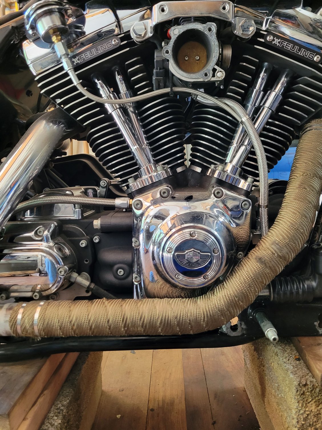

I see we have a common ailment. I see your amber frame reflector is missing. I also found my cam cover was blistered under where the header makes the turn. I did a heat wrap on the front header from the collar all the way down to where the pipes join. Then reinstalled the heat shields. Reflector still good no heat distortation/melting etc. Hoping the cam cover holds up well, will have to check that with the mirror soon.
When the heat shields are back on you can hardly notice the wrap. I know it stops the heat damage to the reflector and hopefuly keeps the new cam cover from simmering until done.
