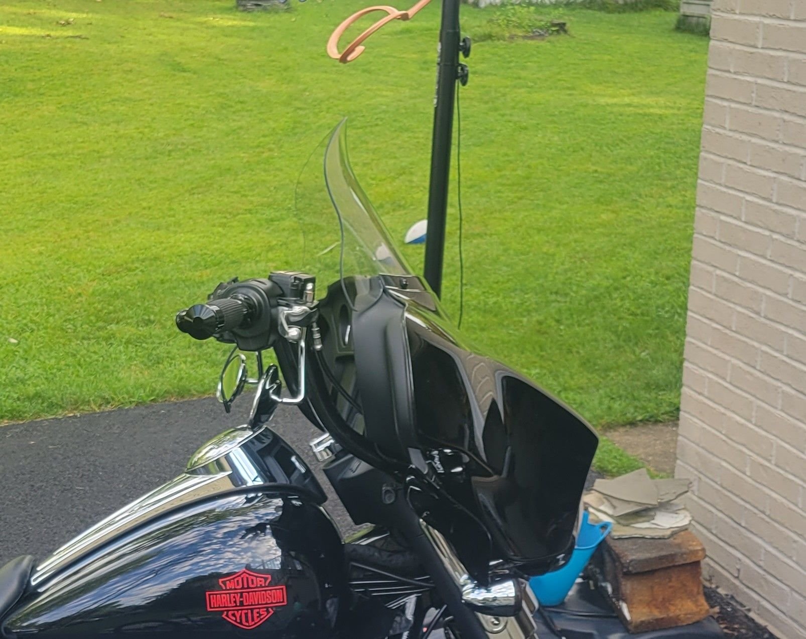

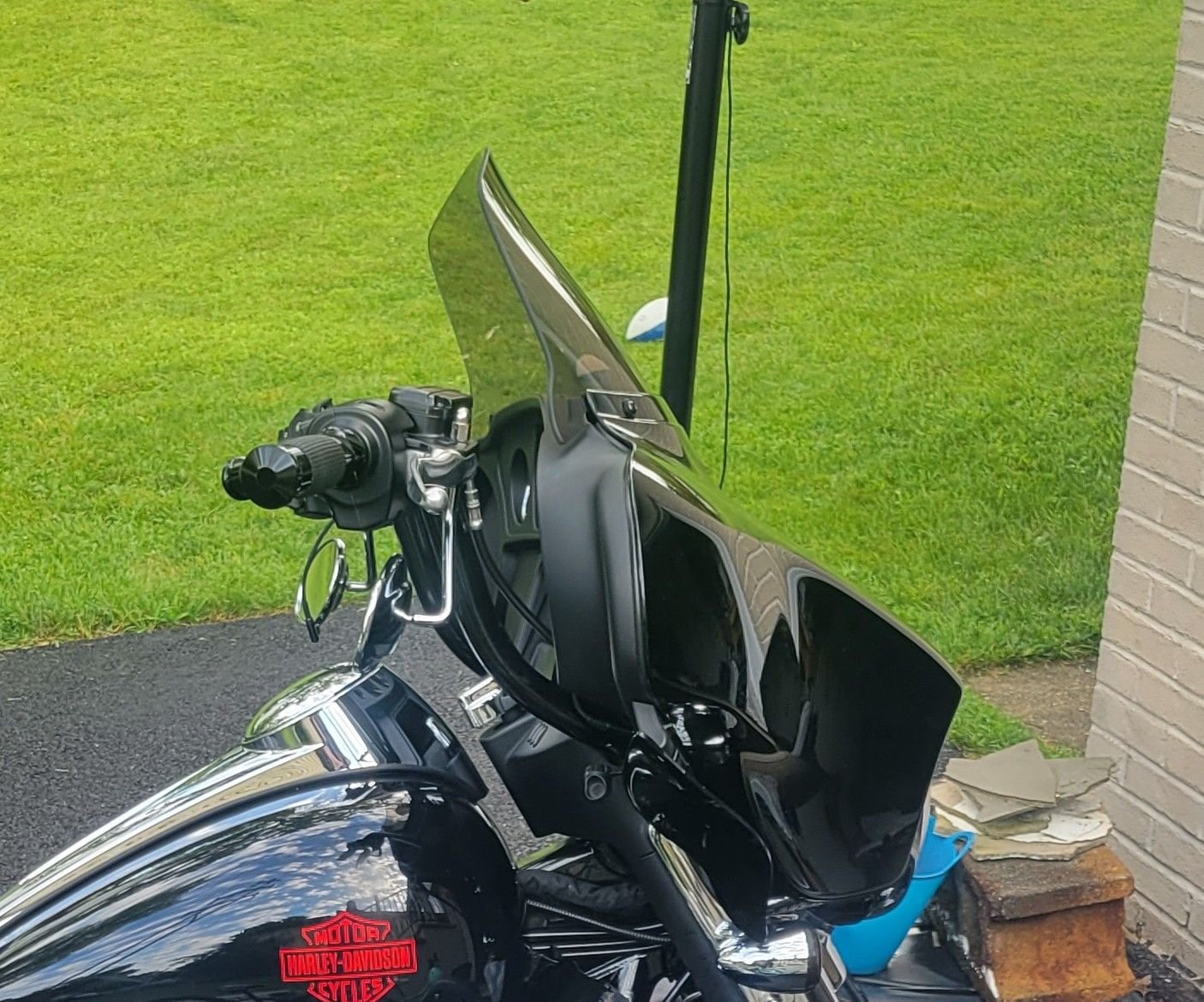

Fangs, dog dish, DK wings and knees closed did nothing for me. Went through a BUNCH of shields in diff heights. Just received a Clearview shield and went for a long ride this weekend. It's made the most difference. It's designed to lay back more towards you. All the others get very steep and the flip is almost vertical. I think those create turbulence.
With the more laid back screen the wind was def much smoother. Feel and sounds. Was also more stable at high speed. That was a great surprise.
Top is a Long Ride with flare. See how it's vertical at the top? Bike felt like a brick at high speeds.
Below is the Clearview. It's about 1" shorter but was def smoother at all speeds. Another benefit was more air flowing into my full face helmets top air scoop.
(FYI....the LRS is a quality shield. Not trying to diss another co.)
