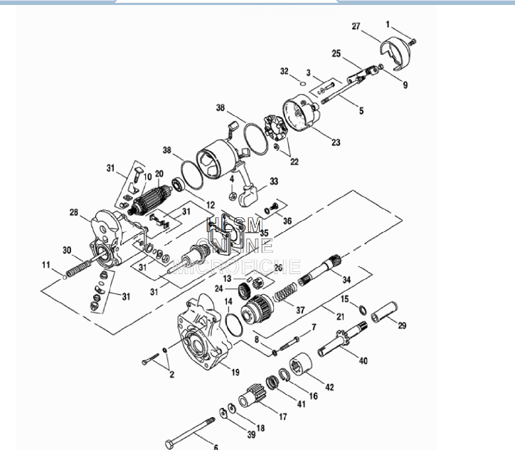

https://shop.suburbanharley.com/oem-...vidson%c2abaly Sorry link doesn't work like I thought it.
You can look up an exploded view of your starter Dang It
I probably won't mention it but did you find the little %$&#@ ball # 11 during the tear down.
Was told if not in there that ain't good.
Found it and had to ask where the H^$ it went.
Tore back down and put in
Good Luck WP
Good Luck WP
Thanks.
Yea i put the little ball in the starter. I bought a kit from Harley that had all of that.
Thanks for your response.
I might take the primary back off and see if the jack shaft is engaging. sounds like it's free wheeling.

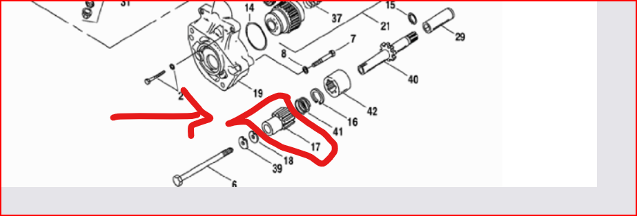

Talking Starter Road King - Jack Shaft Fixed Problem
Ok.. Thanks to all for your replies and helps.
Here was my Solve..
I pulled the Primary cover back off and ........ My Dumbass Error. I'm posting this in case anyone else might need some help or might make the same error i did.
I put the Jackshaft Gear on backwards!! In my excitement of getting the starter back in and in my haste I flipped part 17 backwards. See Pix below.
It would start the bike but eventually unscrewed the jack shaft bolt completely creating the 'Whir".
I noticed when i was torqueing the Jack Shaft Bolt it did not seem to want to Torque correctly / therefore i was bending the Thrust Washer inward on the gear..
Turned the gear over / purchased the two new washers / Toqued it down and i'm good to go..
Sometimes it pays to slow down and refer the maual more than once.
Be kind, i already admitted it was a Dumb *** Move on my part. LOL...
