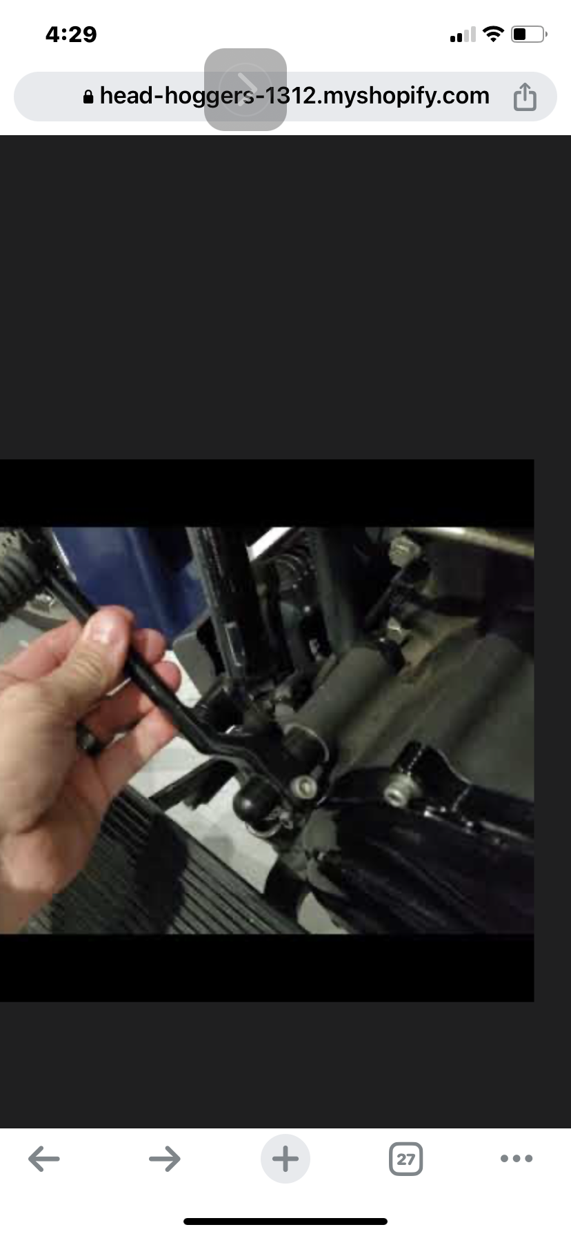

Yes, when disconnected the shifter shaft rotates very easily and freely.
huh, ball ends? It’s the shifter shaft that has splined ends that connects to the toe shifter and the front shifter shaft, then connected to the shift linkage them to the transmission shift shaft; see below.
What is the "new chrome shift linkage rod " ?

Sorry, didn’t read or understand your above post fully…the new shifter linkage has heim joints at each end and neither are bound up and rotate freely. Nothing causing either end to stick or get caught up that I can see. It’s also the exact same length as the stocker I removed.
