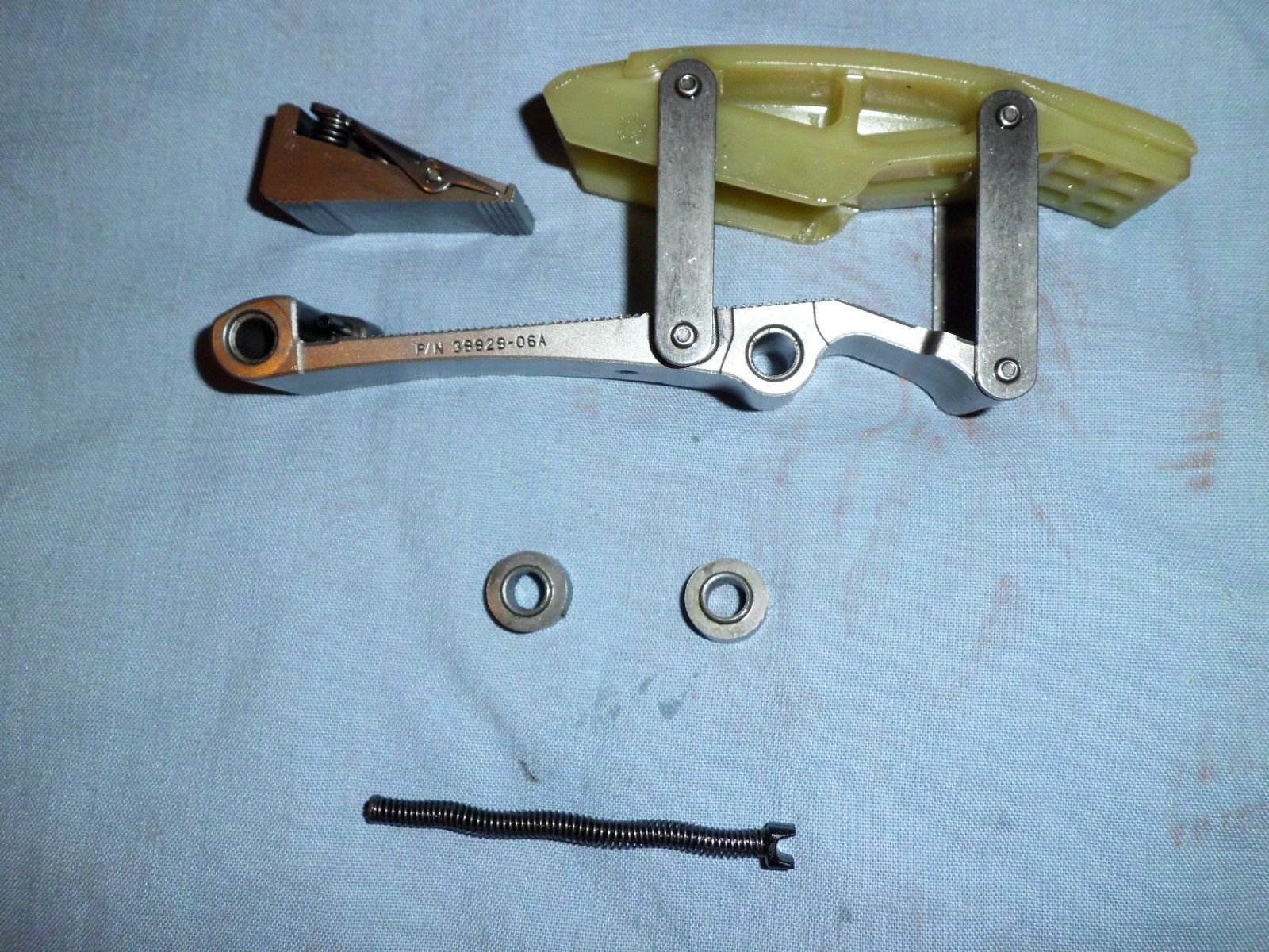

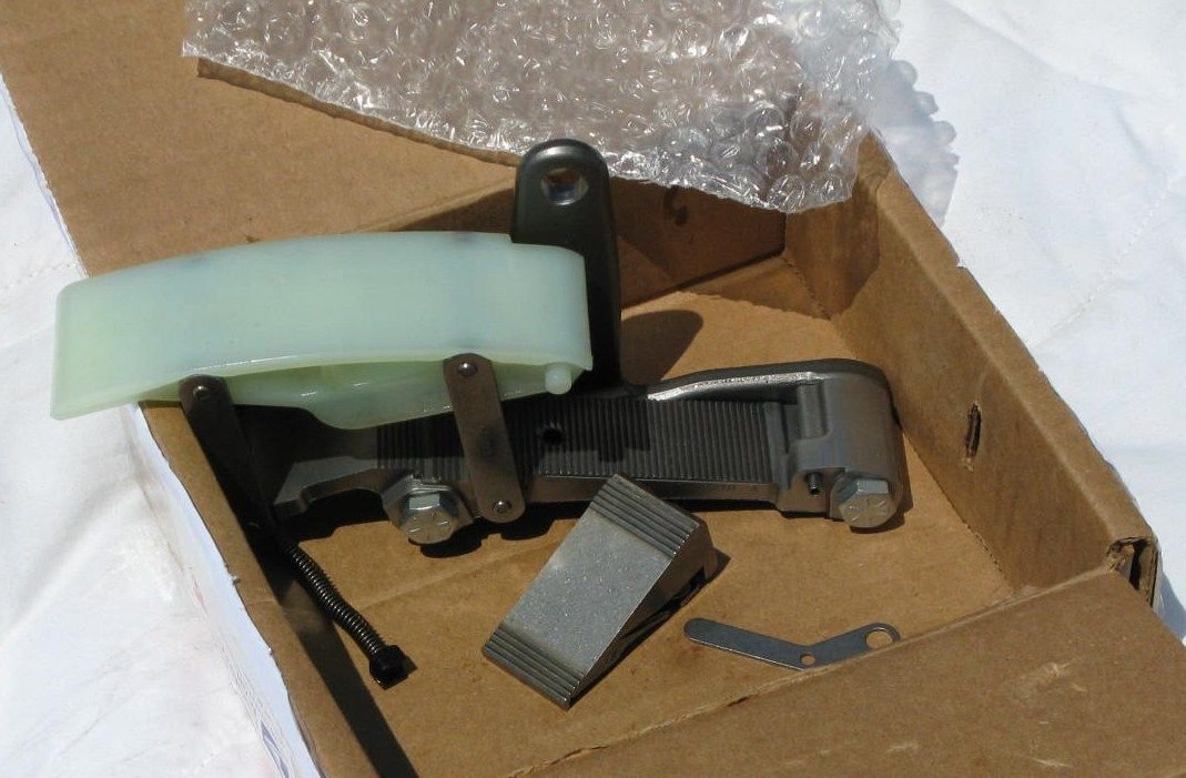

Everytime you you let off the throttle and the engine acts as a brake, it sets the the latch system. Then when you throttle, it tensions the chain. It will only catch a new latch if it's a little over 1/2" free play.
What makes it so quite is those two coil compression springs in the base. To see the full play, you have to push a lot harder on the upper chain section then one would normally push a non automatic chain tensioner, to flatten those springs..
Last one I put in, after cutting the zip ties, , clicking it in a lower gear, I just bumped the rear tire back and forth a few times while up on the jack.

It really adjusts when accelerating. That is when there is tension on the top of the chain and the bottom is loose. One of the things to watch out for is hard acceleration while the motor is still cold. That can potentially ratchet the chain too tight tho I suspect the issue was more with the early chains.
What makes it so quiet is those two coil compression springs in the base.
I think you mean the 2 small springs in the wedge not the base.
Gee, what I said. With it up on a stand, not a lot of acceleration. But moving the rear wheel one way and the other is the stimulation of acceleration and engine braking.
But sure not an expert. What it appeared to do when it did that ..
I think you mean the 2 small springs in the wedge, not the base.
Correct there. I just took a quick check before giving a generalization to say to the first poster all good. Sure it would reset but I thought I wanted it working and close before putting the cover on. But now you're probably like the post directly above yours. Mr lonebone. I guess he didn't even contribute anything for the first post except trolling me.
