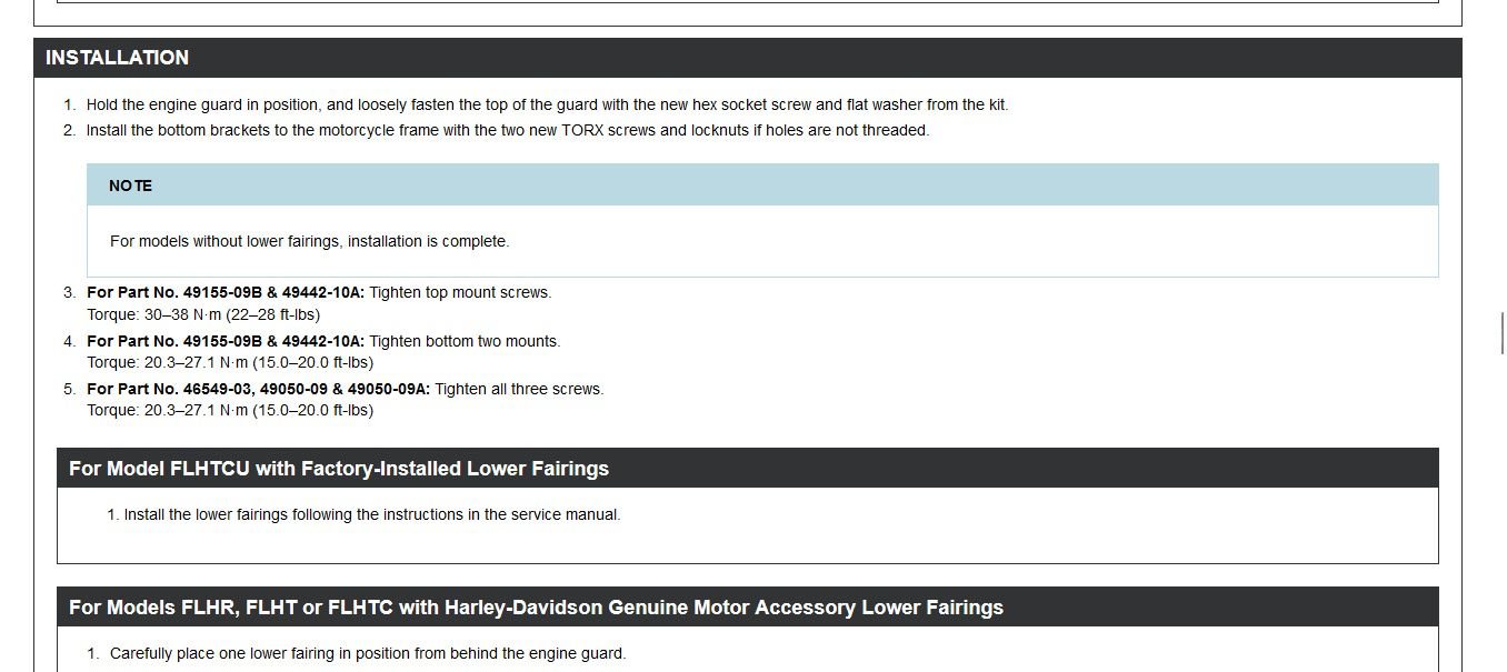

Originally Posted by Ken45
Tab is welded to guard and tucks up under and behind the bracket with the hole in it first, then swing the guard back ant the install the lower mounting bolts. I would start the "tab" bolt first but leave it loose tighten after lower bolts are started.
Damn shame they didn't describe it the way you did. With an oil line in the way and not getting down on the floor I did not see the slot in the frame. I am a stickler for reading manuals and instructions. Bu many do not describe things very well. Thanks.
Glad I could help, especially a combat vet, a handful of purple heart vets in our family. I am reluctant to crawl on the floor myself, the knees are not what they used to be.
