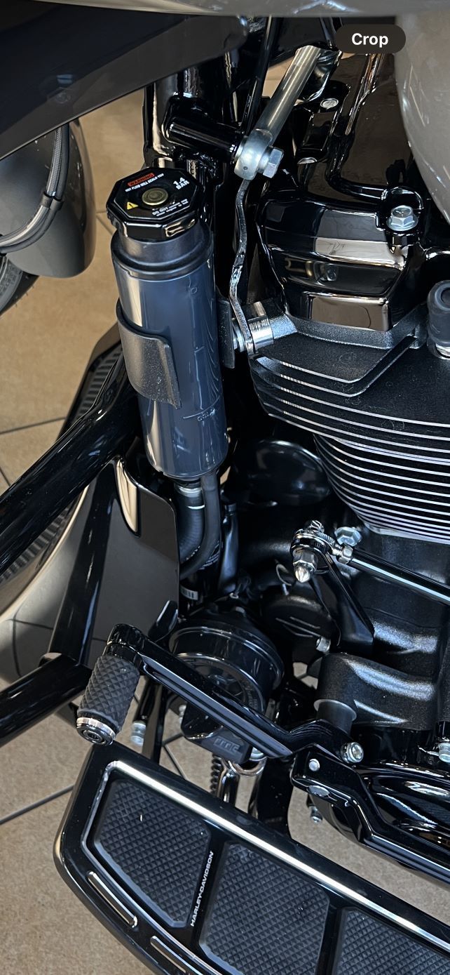

Originally Posted by NorthWestern
Looks like the key is involved. That must be the tool?
That brass peace in the center of the cap is where they pressurize the system after the cap is on. That's what my dealer told me. When I was looking at it.

Originally Posted by Ultra103
Specialized tool must be a glove.
So you don't see the 1.4 bar on the cap. Yeah next time put your glasses on. The system has to be pressurized after being filed, bled and cap put back on. If you can do that with a glove you should get a job at HD.

I wouldn't think that someone has to pressurize the system, the coolant is going to pressurize itself as it heats, the deal in the center my guess is to release pressure if it gets to high from overheating which isn't a real good spot to do it in right next to your leg

1.4 bar = 20 psi, most automotive cooling systems run 14-16 psi so 20 psi is not out of line, the main reason the pressurize a cooling system is to raise the boiling point at 1.4 bar the boiling point of water is about 228f, I think your dealer is full of it! but I could be wrong!

Pressurizing the system will only test for leaks. Are you/they confusing this for vacuum purging the system?
