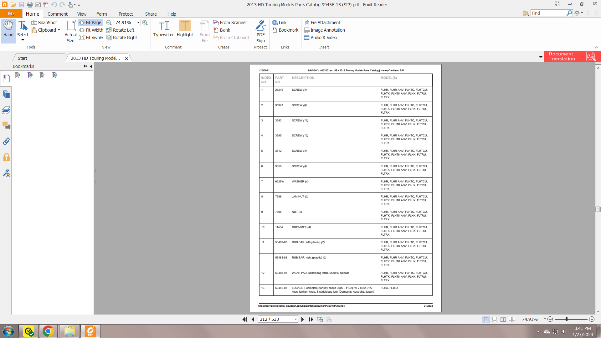

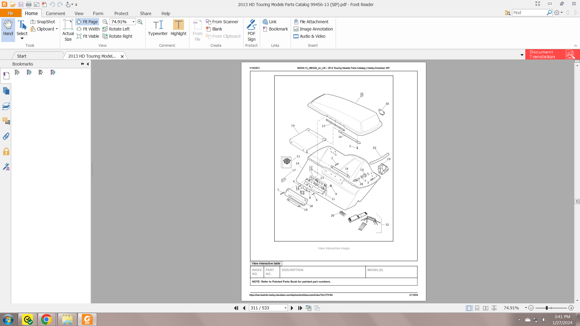

I am in the process of putting new saddlebags On my ultra. There is a black rubber bushing that the pins go through to hook the bag to the frame. Is there a trick to changing them? Feels like I am going to tear it if I try and force it through the hole.
Thanks
Old Jan 27, 2024 | 02:43 PM
Uncle Larry's Avatar
Uncle Larry
Posts: 157,518
Likes: 57,070
I'll assume you are referring to part #10 ... Warm it up a bit ... apply a bit of lubricant and work it in :>

Yep part #10. I will try heating and lubing and see if I can get them out. Thanks
