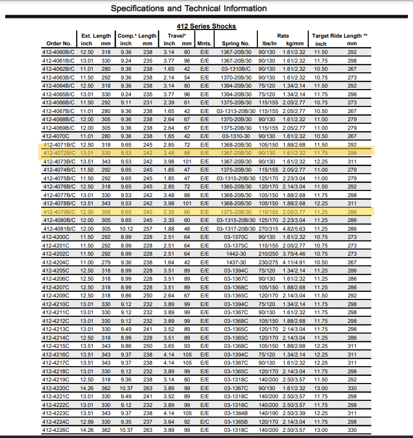

Unless I'm wrong, I'm going to disagree JINKSTER. Progressive has many springs and spring rates for the different length shocks. However, they also have the same spring rates for the 13" and 12" shocks. I think it would depend on the stroke of the shocks that might determine the spring rate. They have 12" shocks with 3" of travel with the same spring rate as what you have on your 13", Progressive model # 412-4049B/C as an example. They also have an 11" with 2" of travel with that same spring model # 412-4005B/C. The proper sag on these would be about 1/3 of the stroke.
I've also been looking at Progressives for my XL1200C, which has 12" shocks, but I also want a longer stroke than the OEM and to match the chrome.
@RKZen Oh boy, okay, here's where it gets down to the grimey road! LOL! So here's the dealio...
What it gets down to is "Bike Fitment" when ordering so if you select a Progressive 312 Series Standard 12" shock for your FLH you will get greeted by Part# 412-4079B/C which has a lowly 2.35"s of travel on a rather stiff and spikey 115/150 coil spring (and the dealers/manufacturers have to do this for liability reasons to keep the bike from bottoming out) where if you order up the Progressive 412 Series Standard 13" shock for your FLH? You will be greeted by Part#412-4072B/C which has a somewhat generous 3.48"s of travel with a much plusher and more comfy riding 90/130 coil spring and they can do this because of the extra travel in the shocks stroke which in turn is suitably compensated for via factory set damping.
I've highlighted the specs for both the 13" and 12" 412 Standard Shock specs in the image below...
