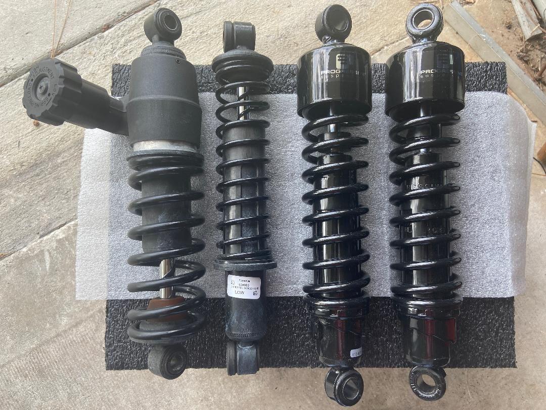

I can't speak to the Ohlins version but I can speak to the 13" part of your question by offering up these shared observations and experiences...
The 12" OEM shocks have absolutely "Zero Static Sag" and unless you weigh >250lbs? You'll experience "Zero Ladened Sag" as well meaning the spring on the left side is so resistant to compression that unless you pile on extra weight via loaded for a trip or riding two-up or hit a bump? The shocks are always locked at the top at full extension because this is the way HD got to advertise "Single Side Adjustment" because the monster sized spring on the left shock (adjustment side) is so strong? It simply overrides the wimpy Bic Pen sized spring on the right shock...
So what going to a 13" shock does is gives the bike (and the rider) the ability to properly adjust some static and ladened sag into the mix which loads and compresses the shock in such a way that there "Travel Extension Available" to help maintain your tires contact patch over rough surface road conditions and what a properly adjusted for sag 13" shock doesn't do? Is it doesn't affect ride height by any significant amount unless? You wish to run'em tight (for increased feedback ad performance) by increasing spring preload.
Going 13" has been a win/win/win for me.

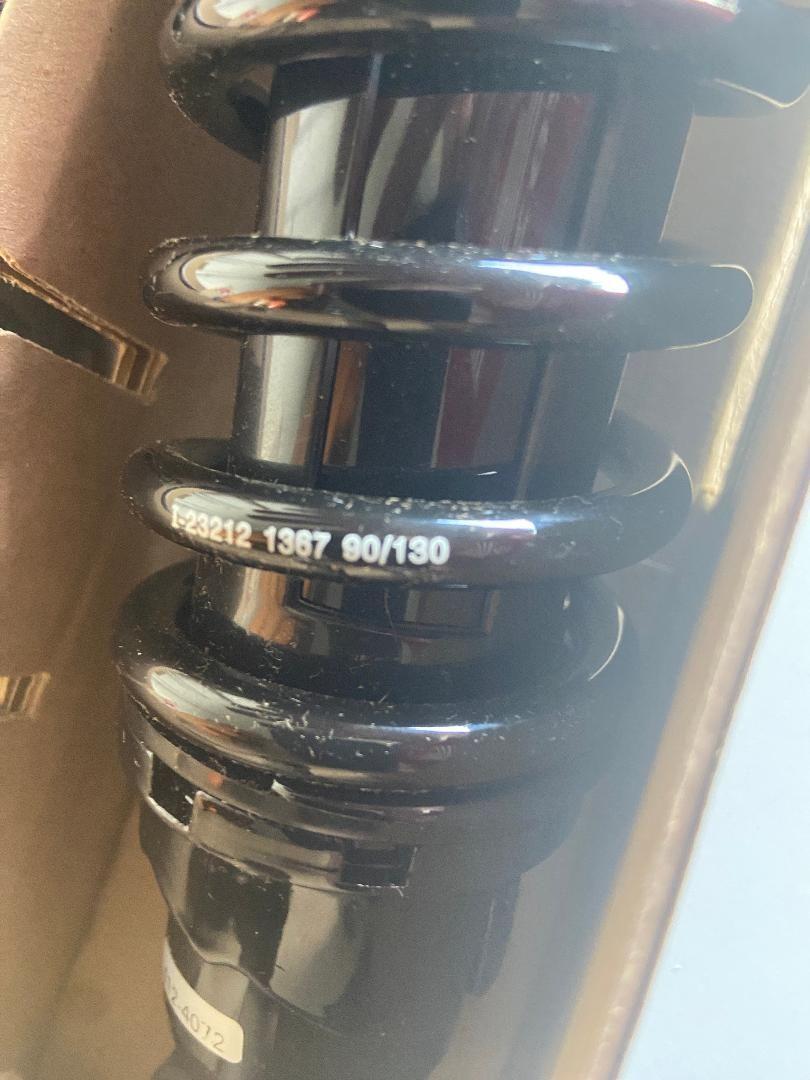

Because a properly sprung/adjusted 13" shock compresses about 1" under the ladened sprung weight of both bike and rider where the stiffly sprung 12" shocks tend to not compress unless acted upon by a speed bump or pothole.
If you order a Standard Sprung 13" Progressive 412 shock you get a softer 90/130 progressive rate coil spring whereas if you order that same shock in the 12" version? They will come sprung at 115/150 which is considerably stiffer but have to be to keep them from bottoming out due to lack of travel and they? Will have a tendency to retain their "Overall Free Length" even when subjected to ladened sag.
Edit: Short answer? 13" shocks are sprung to compress, 12" shocks? not so much.
