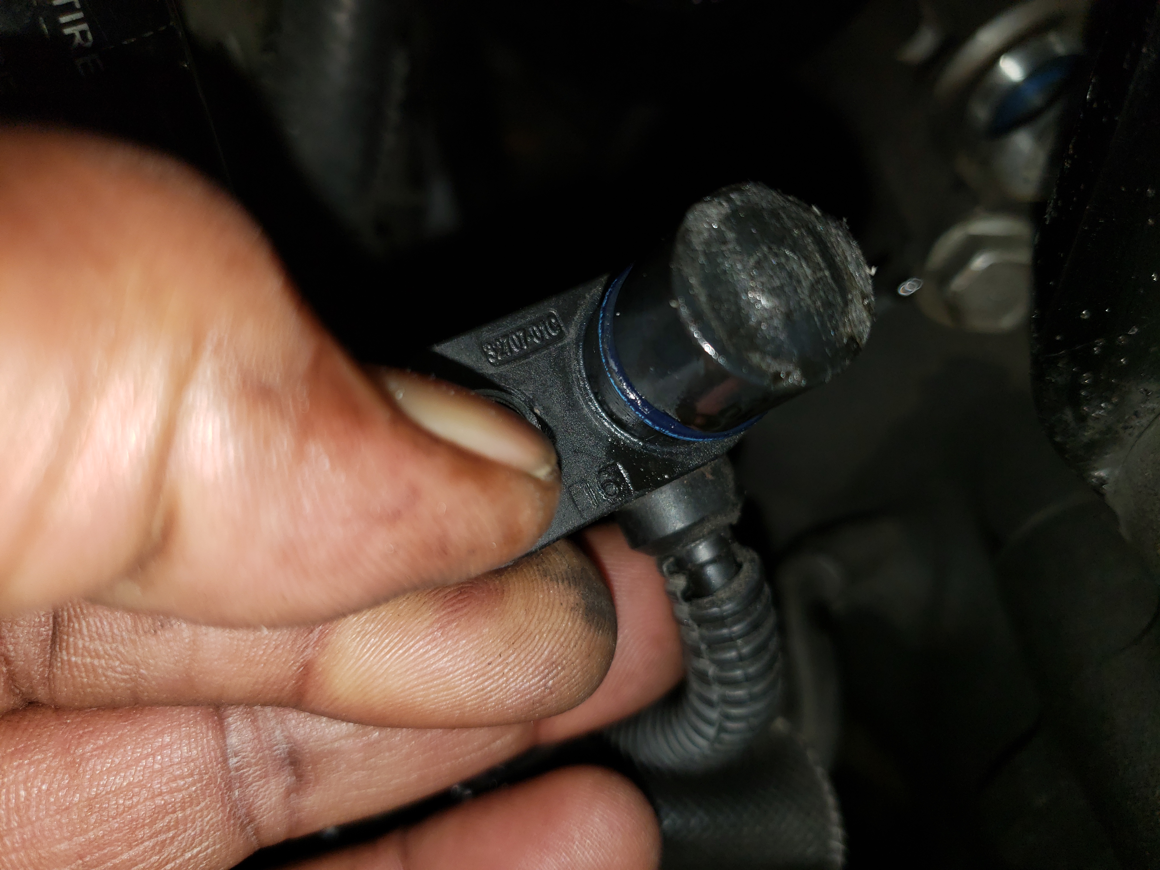

Yeah. If the CKS is smeared, OP got big problems.
mine was...I guess those chunks of piston skirt played a roll.
Did he post more than one thread? Don't see anything about pistons here..
nah..that was the issue I had when my sensor was trashed. swapped the sensor before I tore it down and the bike still ran but damaged the new sensor in short order which precipitated the teardown.

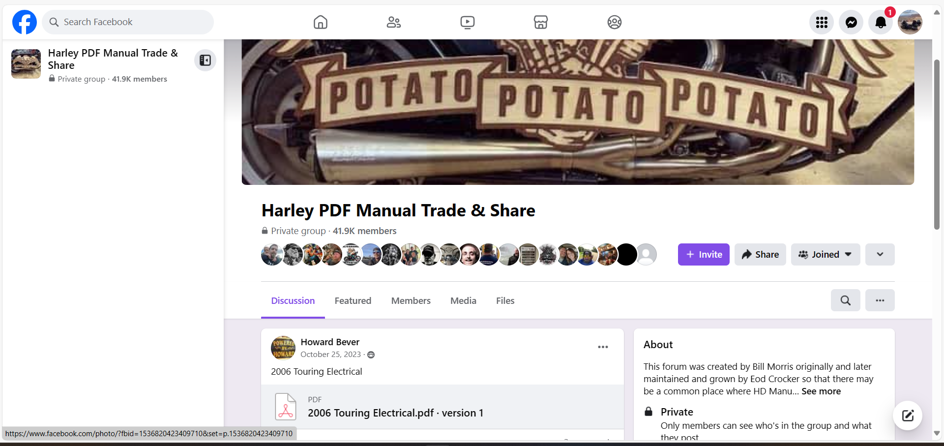

@Pistol Pete 1911 Go to this FaceBook site and click on Files, type in 2006 in the search bar and scroll down to find the Electrical diagnostic manual. Download it to your hard drive.
The manual tells how to get the DTC's and in Section 5 the is a troubleshooting guide for starts then stalls.
Another way to ding the CKS is to twist the crank..
yes...i see a runout check in his future. when i had this carnage the runout was still in spec at 0.006.
