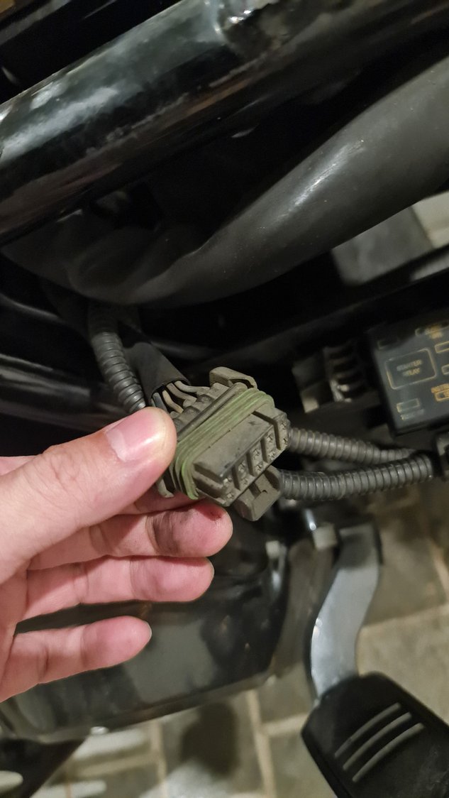

Two weeks ago, I painted my 2007 Street Glide and had to disconnect some cables. Now that the painting is done, I'm reassembling everything. I found this cable that is not connected. Do you know what this cable is for (near the fuse box)?
When I turn on the ignition, the dash lights up, but when I try to start the engine, it just makes a clicking sound near the fuse box. Upon inspection, I found this disconnected cable.I have attached a video. Do you know what the problem might be? Why won't my bike start?

Is that an 8 pin connector, so 8 wires going in.

To me, that connector looks as if it’s been tucked behind or under whatever for some time. I’d expect that green gasket to be better looking. You don’t recall unplugging that one? But, if the battery is fully charged and it still clicks, maybe that plug is to TSSM? Regardless, the receiving end (if used) has to be nearby seeing there’s not a ho-lot of lead on that harness.
