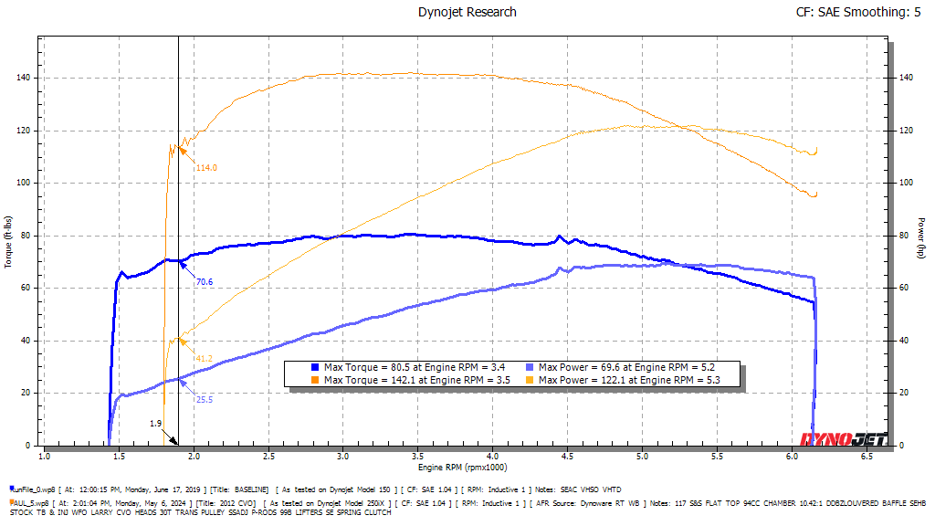

HD stage 4 kits leave a lot on the table. Since 96/103/110/113/117 all take the same flywheels, I'd bore the cases, have Darkhorse rebuild the flywheels, and use the S&S 4.125 cylinders & pistons, and WFO Larry ported heads. All new bearings, cams to suit your riding style, and enjoy for another decade.
If you can find a set of take off CVO heads, the 117 really shines.
This is my kids 117.
