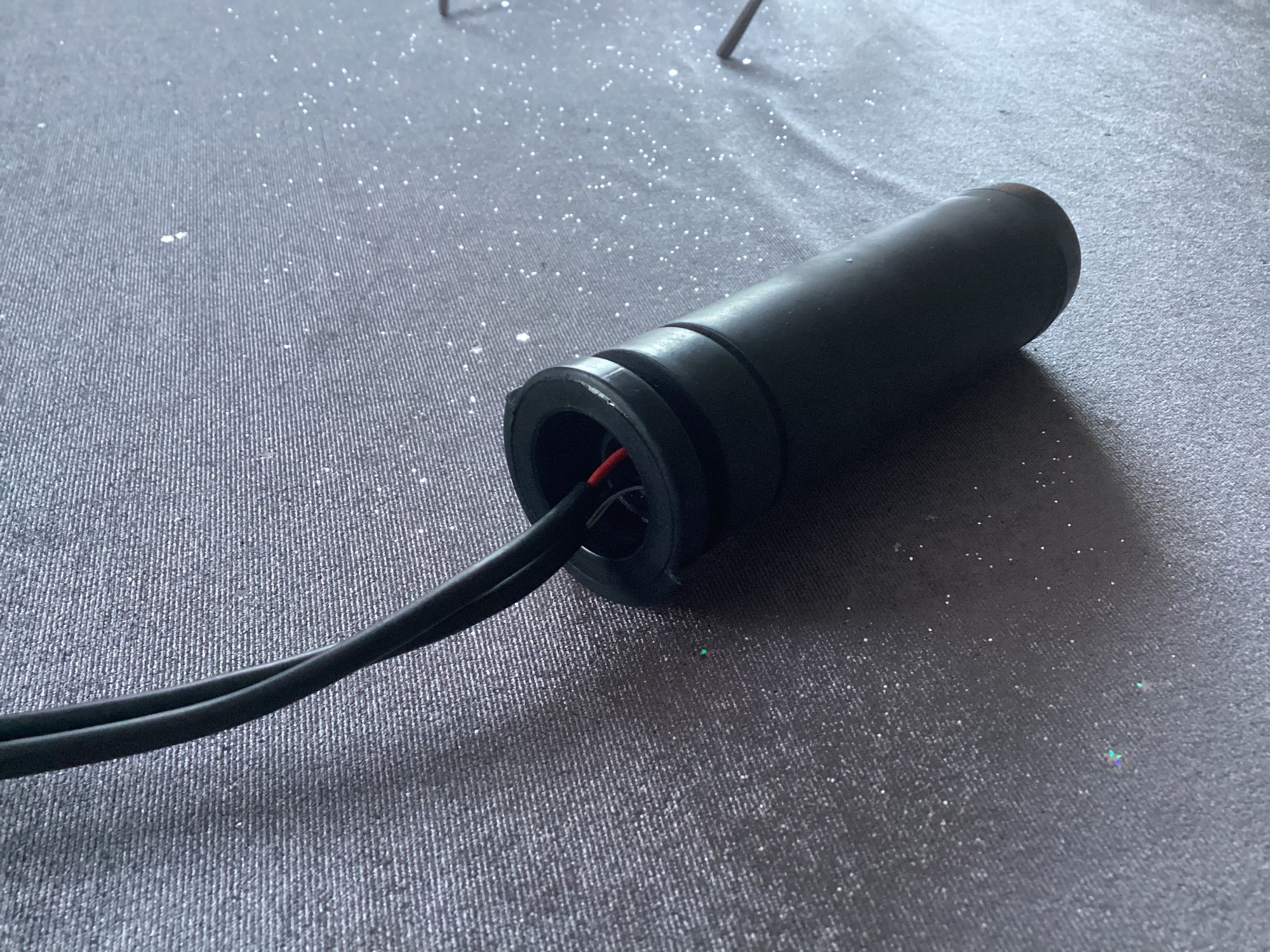

Hi. I have looked around in shops around in my country, for heated grips to an Streetglide FLHX 2011. My old ones has stopped working, so I need some new ones. The old ones is internally wired, but I only find externaly wired in the shop.
So I wonder: Where can I buy heated grips with internally cables?

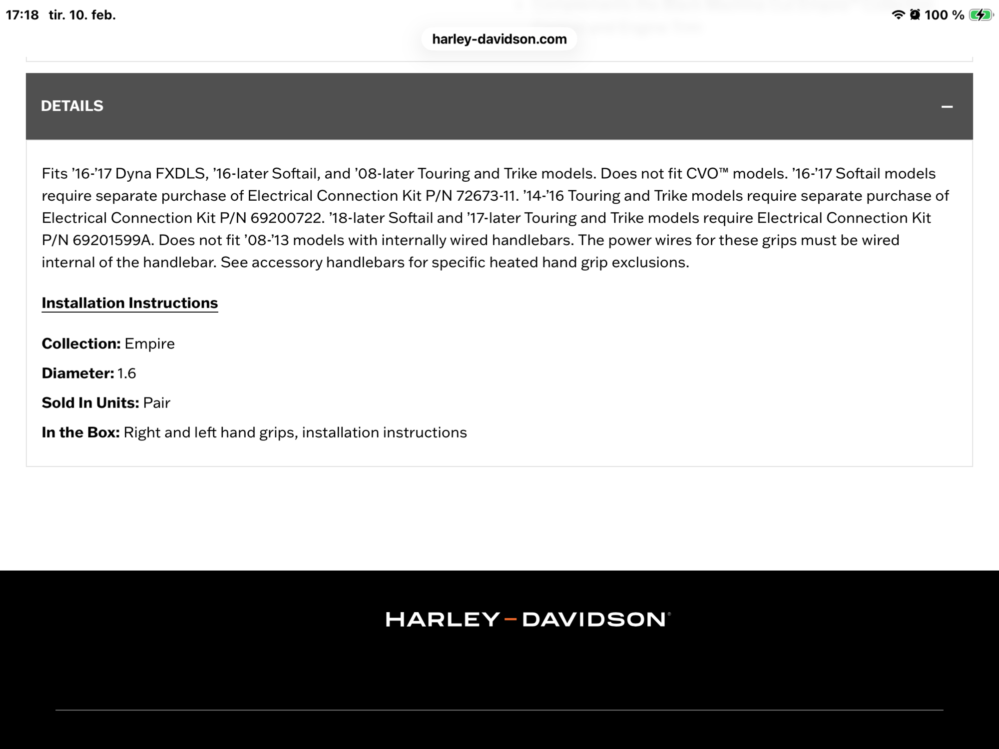

If you look at all them here, they don’t fit 08-13 with internally wire

The grips you’re replacing are internally wired. There’s no reason the new heated grips shouldn’t work. Just curious, do you have stock bars?
Probably the reason they say they don’t fit ‘08-‘13 is because you would most likely need to remove the wiring from the bars to install heated grips, which means de-pinning the connectors.

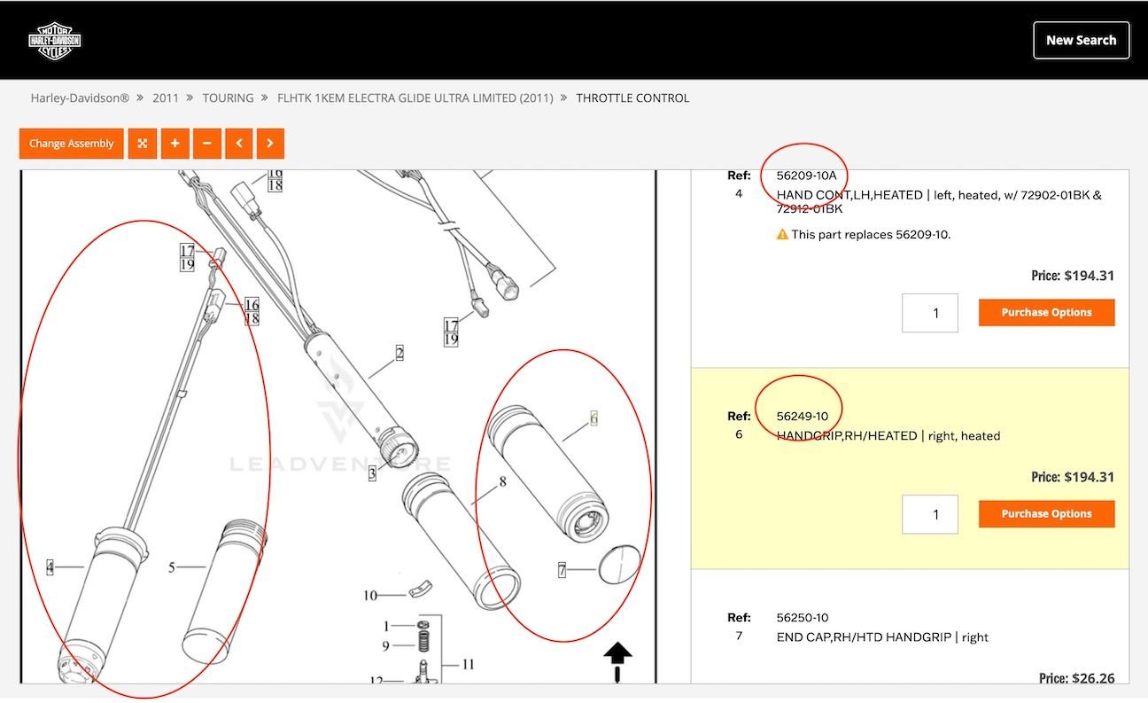

The 2011 STreet Glide did not come OEM with heated grips. Yours appear to be the OEM heated grips used on the Ultra Limited models.
I added the OEM Ultra Limited heated grips to my Ultra Classic which didn't have them OEM. It was a popular mod, and seems that a prior owner of your bike did the same.
In any case, those 2011 OEM heated grips, while expensive, are still available from a dealer.
Good luck with your repair.....

I agree with @GalvTexGuy . I have a '13 King with 1 1/4" bars. At the time, my dealer had some left-over 2012 CVO grips on sale and I installed them internally on mine, along with all the other wires. The skinnier bars makes it tougher to pull the wires through, but can be done. Just make sure everything works before buttoning everything down. 12 years now and the heated grips work just fine.

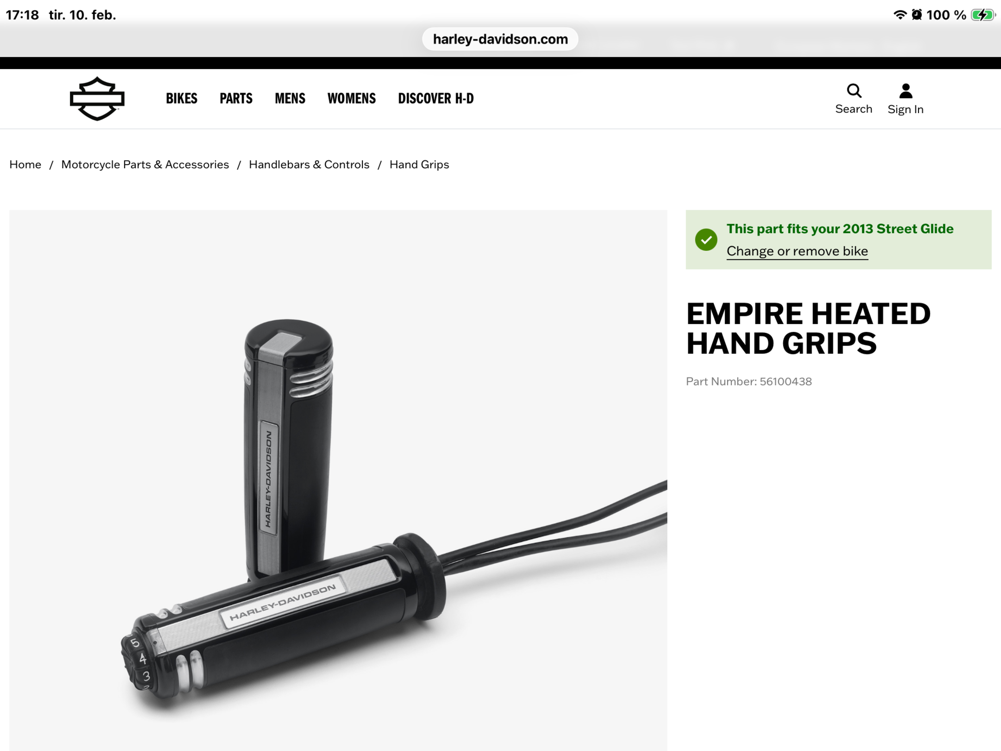

I have found grips now with internal wires. I have to put new wires anyway, because I change my handlebar to an 14 inch handlebar at the same time.
i also change brom black to chrom switches and take the wires there internally too.
I wanted the Airflow grips in Chrom but they had the power cable on the outside of the handlebar, while the cable from left to right goes internally.
So I choosed the Epire instead, with less Chrom 🥹
