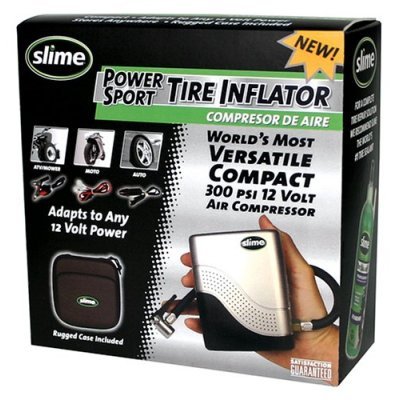

I got my slime compressor at Auto Zone

I bought the Slime Powersports compressor (part # 40001) last night at Advanced Auto Parts for $28.
The thing rocks..It'sabout the size of your hand andcomes in a small carrying case (6"x6")with connections for a cig lighter, battery clamps, and a direct wire set-up.
The wire that came with it just happened to plug directly into my trickle-charge plug that the dealer put on my bike when I bought it. Pretty convienent.
I also bought a tire plug kit from Advance Auto that came with a carrying case.
Now I just need to get a decent tool kit.
Bought mine at Walmart.
