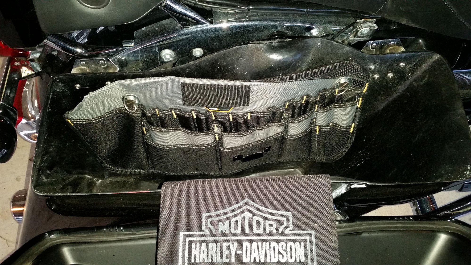

Had to take a crack at the saddle bag organizer. picked up a bucket organizer from Lowes ($12) and went to work this afternoon..... here's the end result! Ended up with an organizer for each saddle bag, so basically $6 per side!
How are u guys attaching the organizer like that inside your bags?....are u just punching holes in the organizer and just putting the screws to attach the bag thru?....doesn't the thickness of the organizer not let them screw in right?....or am I missing something ....ryan
depends on how thick the bucket organizer is. but that is pretty much the concept behind it. I put a small "X" in the material so it fit snug around the mounting bolt.
