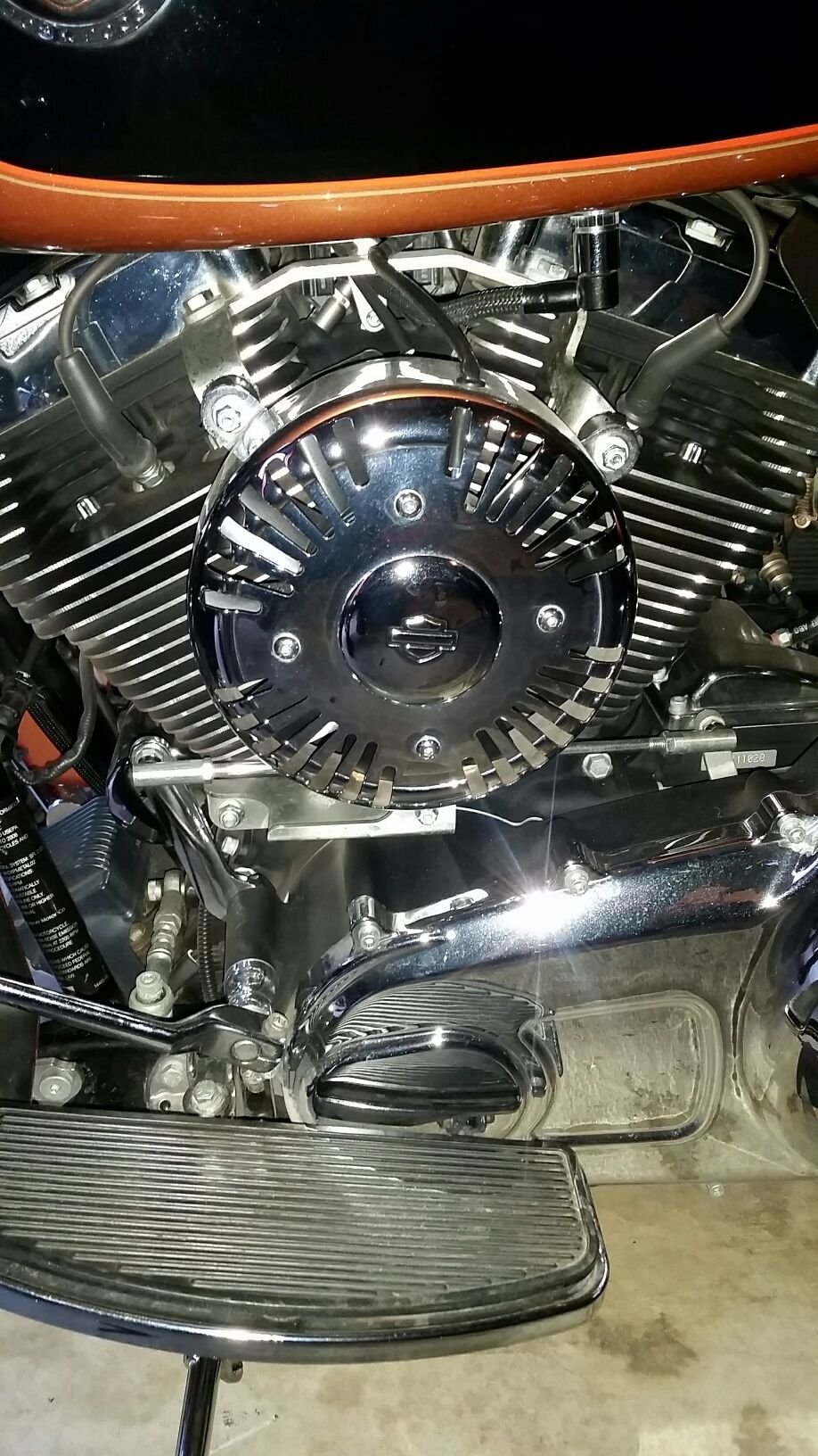

Another horn mod ... When I bought my 08 Ultra, It already had a Harley fan installed where the horn would go. The horn was re-located to the right front of the gas tank. It was a small 2/12" diameter, black, fugly and not so loud horn. Rather than spend 100 or more on the "better" horns, I bought a sick speed horn off E-bay. It was plug and play and WoW is it loud! This horn is chrome, looks great and 20.00 !

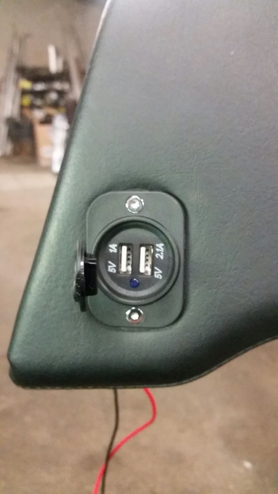

Another little mod I did this weekend. Since I replaced my radio with aftermarket, I had no need for the intercom buttons on the rear speaker pods. I removed the right rear and installed a USB charger for the wife to charge her phone while riding. I bought it on fleabay for 12.00 dollars.
Very nice. Did it take a regular 12v input, or did you need to step it down to 5v?
Old Oct 26, 2015 | 11:33 AM
  #1798
UltraClassicWNY's Avatar
UltraClassicWNY
Joined: Sep 2015
Posts: 142
Likes: 6
From: Clarence NY
No step down, The USB does it. Just run a Pos (12V) and a neg (Ground) to it.
That's what I meant. Didn't know if you could run 12v straight too it, or needed to step down to 5v before the unit. Cool. Thanks for the info.
