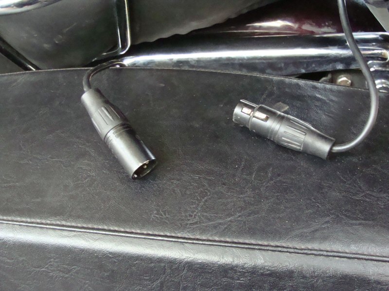

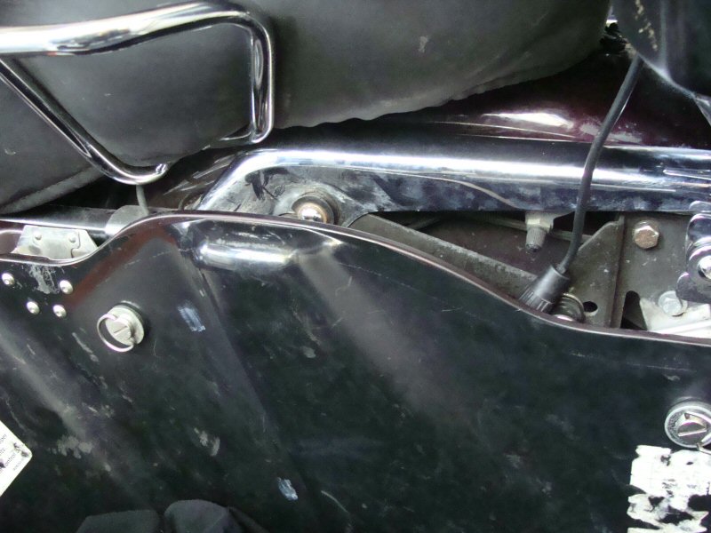

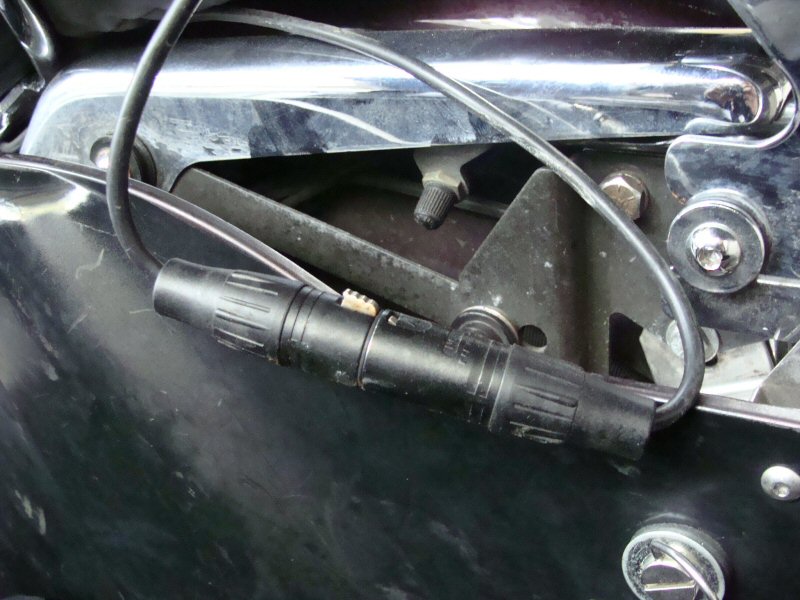

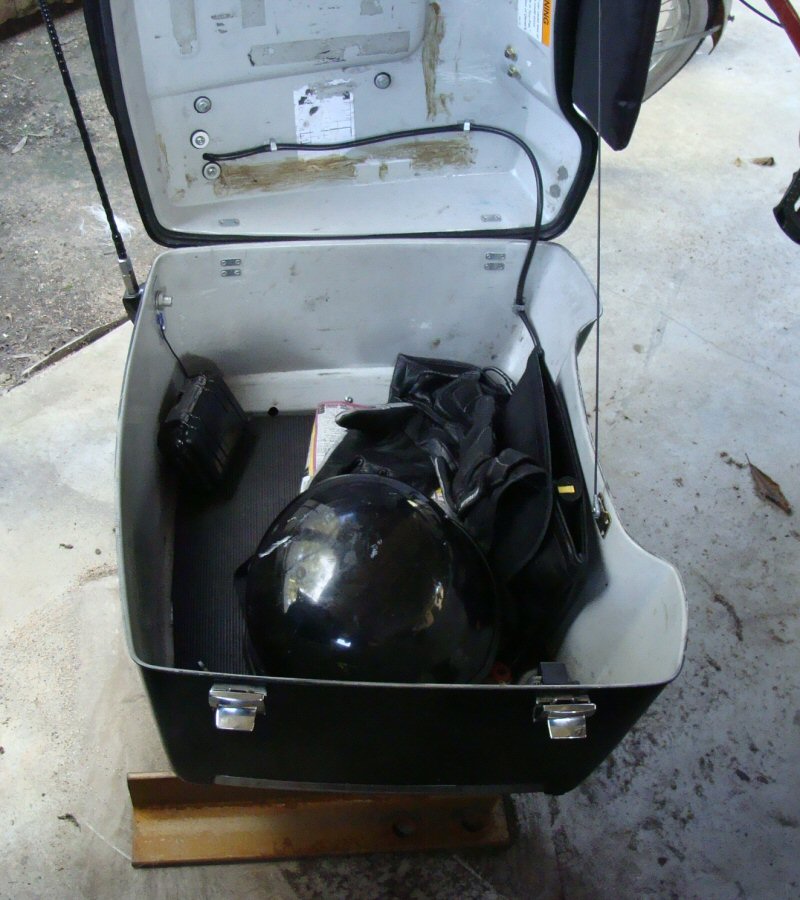

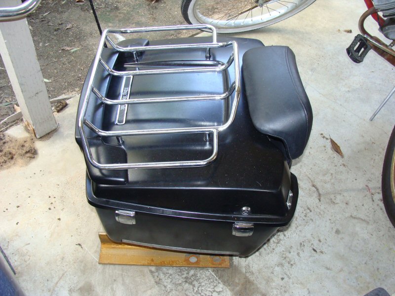

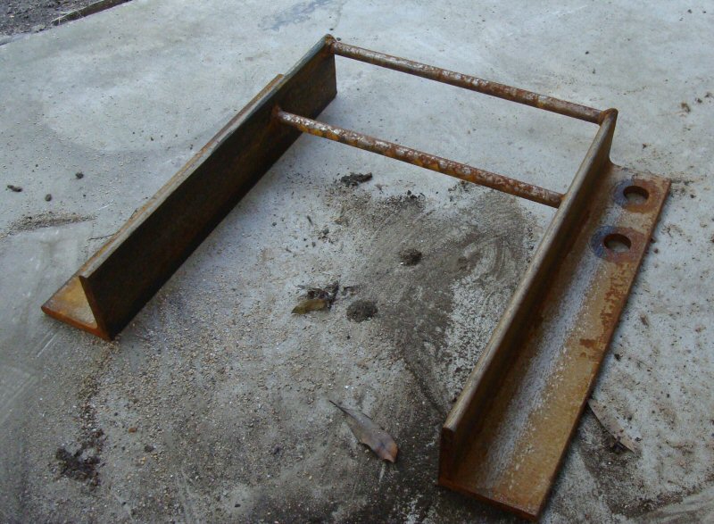

Default what do you do with the f'n tour pak when you take it off?
you mount it on one of these.
cost me 20 minutes of my time. got all the metal for free. 99 cents for the paint that isn't on it in the picture but it is now.
i made it out of fairly heavy steel so it has enough weight that i can open it and use it to put stuff in when it isn't on my bike. next step is putting some nice locking casters on it. seen crap on line all of it over a hundred. fairly self explanatory if you have a quick release tourpak and any welding skills you should be able to figure it out. when i bought my tour pak it didn't have a plug for the brake/running light on the spoiler. I am a musician i have a ton of gear. I took a nice NeutrikŽ XLR microphone cable and used the quick click 3 wire setup worx nice. you don't need to butcher an expensive cable like me. you can buy just the ends but if you use a cheap cable it will work fine and one end plugs into the other end and locks tight. when i am not using it, i have another cable end that is sealed to keep the tangs clean and straight. hope this helps somebody somewhere. this is a great thread. thanx.
