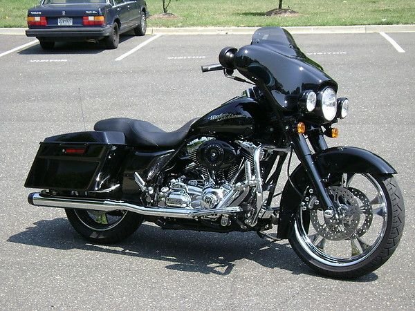

Mighty old thread...but I did it. I have no gauges tho, who needs them anyway. My bike has had a few transformations.
